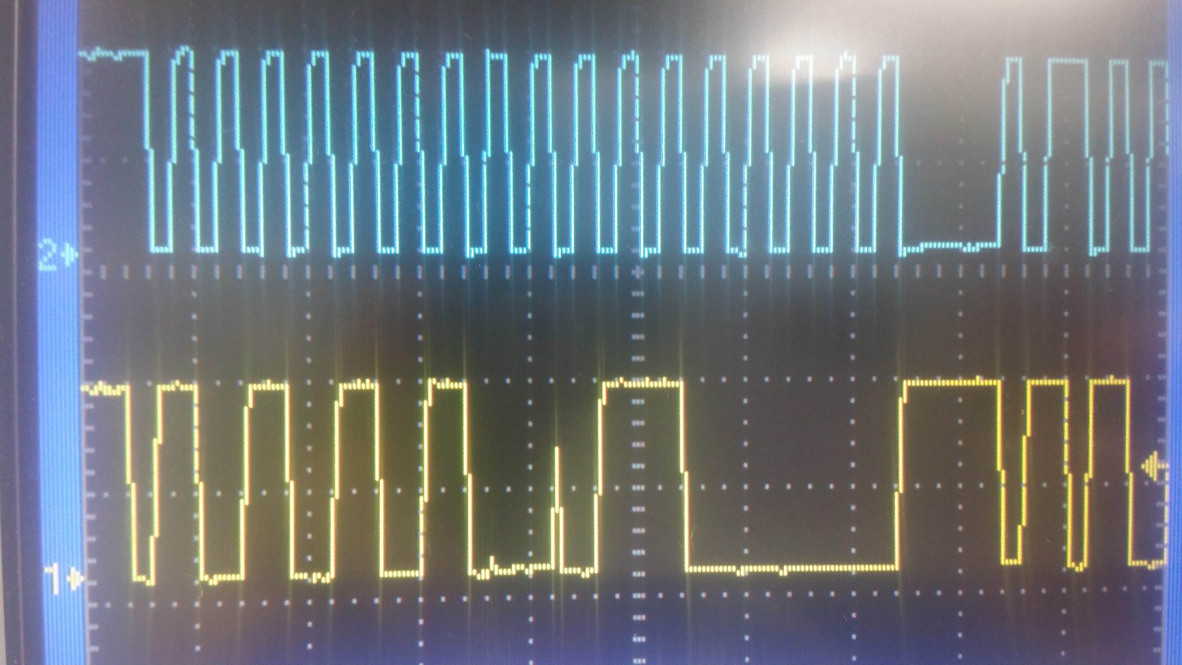

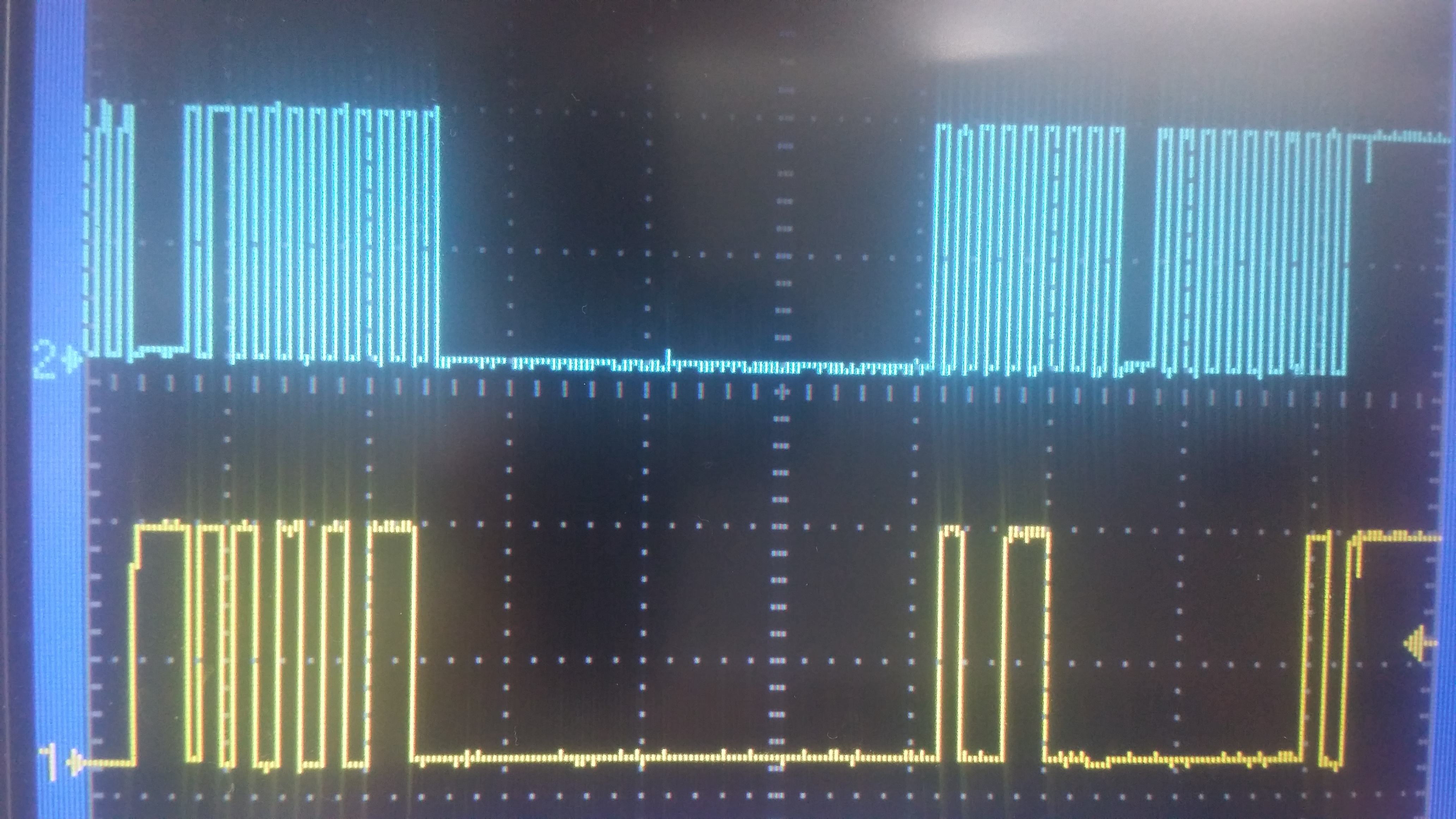

I use STM32F215XX chip communicate with Bq34z110 chip through i2c.
I use two tools.
-> [ 1 ] 'bq Evaluation Software'
-> [ 2 ] 'IAR Embedded Workbench'

but, I have a problem in ' step ( B ) '
[ 1 ] Use the 'bq Evaluation Software'
[ 2 ] Use the 'IAR Embedded Workbench'
- front
- back
All '4C 00' appeared.

Can you see me the 'bq Evaluation Software - DataRAM' and 'bq Evaluation Software - DataFlash'  monitor using for capture?
< 2 >
The 'Ack' signal's too weak.
That 'Ack'( = [ 2 ] Use the 'IAR Embedded Workbench' -front ) as possible?
I don't know.
