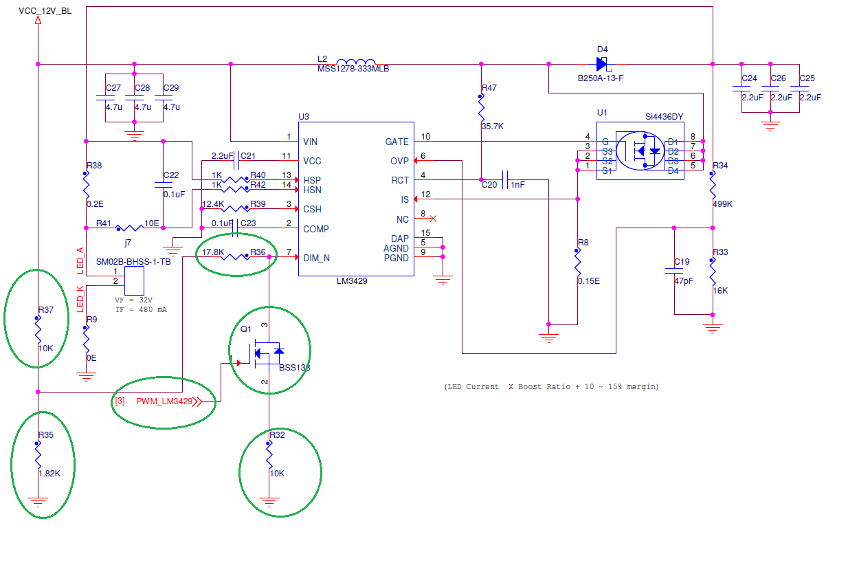

Here I'm facing one problem. The LCD is not displaying data by default. When I probe pin DIM_N (pin number 7) using multimeter then only LCD is displaying data properly. Could you please review my schematic and let me know that whether my PWM connection is proper or not ?

  • Have you tried shorting R32? Q1 should pull nDIM to ground. Perhaps the extra load of the multimeter is allowing it to pull low enough, but the 10k resistor is preventing that otherwise?
  • Dear Clinton Jensen,
    R32 shorted and tried. But still result is same.

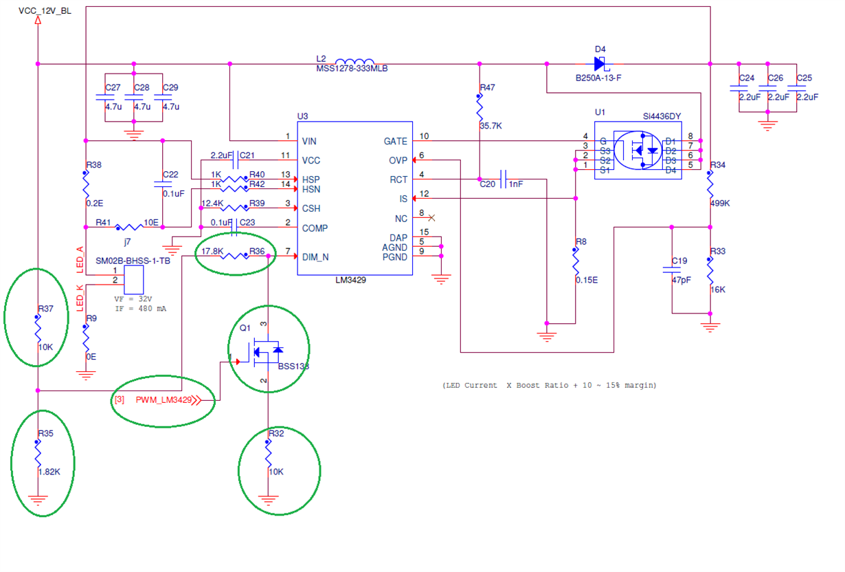

    I hope the working of nDIM pin is like below.
    Case_1 : When Q1 gate is low, drain and source continuity will be disconnected and resistor divider (due to R37 and R35) voltage is feeding to the nDIM pin. Thus the LEDs are blinking.
    Case_2 : When Q1 base is High, zero voltage from ground is feeding into the nDIM hence it is not blinking.
    Consider case_1, what is the minimum voltage is need to nDIM pin to make LED blinking ? It should be more than 1.2V or less ?
    Azlum
  • Have you proved the nDIM pin with a 10x voltage probe to check the levels? When Q1 gate is high the nDIM pin voltage should be near ground (at least below 100mV or so) and when the gate is low the nDIM pin should be above 1.28V. It's also good to probe to see if there is noise that could affect it. If you are borderline and there is a lot of noise it could behave incorrectly.

    I have removed the Q1 and I'm getting 2.2V at nDIM pin. i,e more than 1.28V. This case the LCD should shows something on the LCD. But I'm couldn't see anything on the LCD.

    When we remove N-channel transistor, then I'm getting 1.8V in nDIM pin. In this case also the LCD should work properly. Is it ?
    Azlum
  • With 1.8V on nDIM it should be on. Do you have enough input capacitance to prevent the input supply from dipping when you turn the LM3429 on? Also, did you add extra hysteresis (using Ruvh) as recommended in the input undervoltage lockout section of the datasheet? That can help prevent errant uvlo conditions due to transients.

    I have used RUVH is 17.8K. Hope this is more sufficient. How much is the required current in nDIM pin ? RUVH may prevent sufficient flow of current and causing the problem ? I'm really wondered with this issue. Even I have used less than 17.8K values and tested. It didn't help me.
    Azlum
  • Those values should be fine. So first off, do you have an oscilloscope to look at the nDIM pin with to make sure the signal is correct? By a 10x probe I just meant a high impedance type like 1Mohm or 10Mohm voltage probe, not a 50ohm one which would load things. So some other questions:

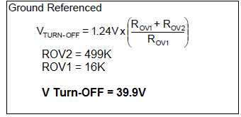

    <<Azlum>> Please find the images “ output_1, output_2, output_3”. These are the wave forms of the output. Since it is sawtooth wave, I have marked the output 3 different levels. OVP calculation is below for my circuit.

  • The output pictures make it clear, you are going into OVP. I know you set the level at 40V, as you can see it goes up to 45V (not uncommon given internal delays and the small delay caused by the 47pF cap) then turns off. The hysteresis is set at 10V so it should turn back on at 30V input which it does. That triangle wave is not due to the device switching as it is way to big and only at about 8Hz. So your LED string voltage must be higher than you think it is. You could test the easily by removing the 499k OVP resistor and see if it works, then you can measure your actual output voltage if it does. Sometimes LED forward voltages are specified at a certain die temperature, but they are always higher when cold and drop as they warm). I also noticed that you have your current limit set at only 1.6A, that is pretty close for this application. I would give more headroom and lower R8 to 0.1ohm or less so you don't run into current limit issues (if you do the output current will drop, particularly if you lower Vin).

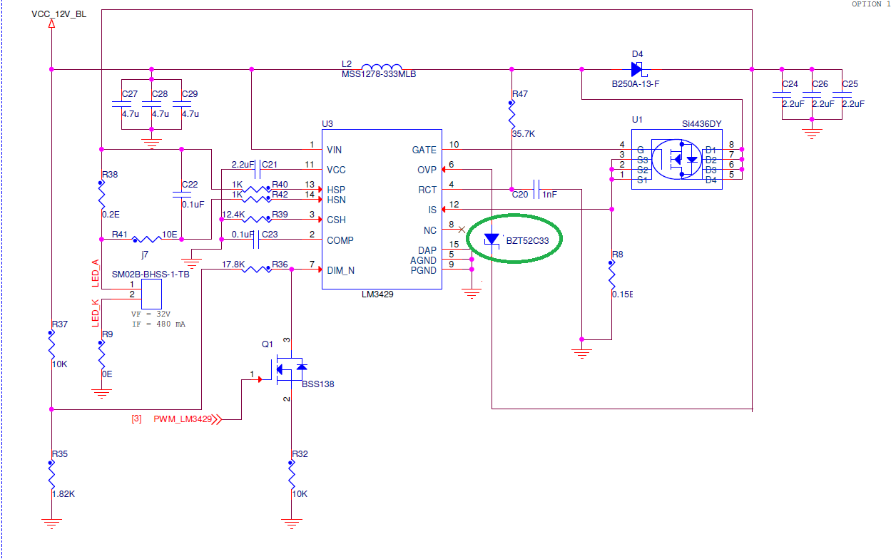

    I have removed 499K and tested. Still I cannot see anything on LCD. The required minimum back light LED voltage is 32V as per LCD data sheet. But when connected the LED’s anode and cathode (i,e load) to the driver IC output the expected voltage showing in the multitier is 28V (i,e expected voltage is not coming in the multimeter).
    1) How can I maintain the 32V with 499K removed condition ?
    2) Can I remove R33 and R34, then connect 32V zener diode across U3.6 and D4 cathode side (as below )? Is this good to try ?
    Azlum
  • Ok, you shouldn't need to remove the 499k and a zener will not work correctly since the OVP pin will try to source current when the threshold is exceeded. The RC should be fine and 499k is probably fine.
