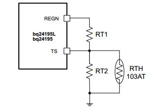

Dear all,
I always get a fault from the fault register (REG09 = 0x23) no matter when charging or discharging.
BQ24195 can charge or discharge without problems. When I increase the temperature of the themistor, the charger can stop charging. All things look fine except the 0x23 fault.
The figure below is my design. Is there anything wrong with it? Thanks.
