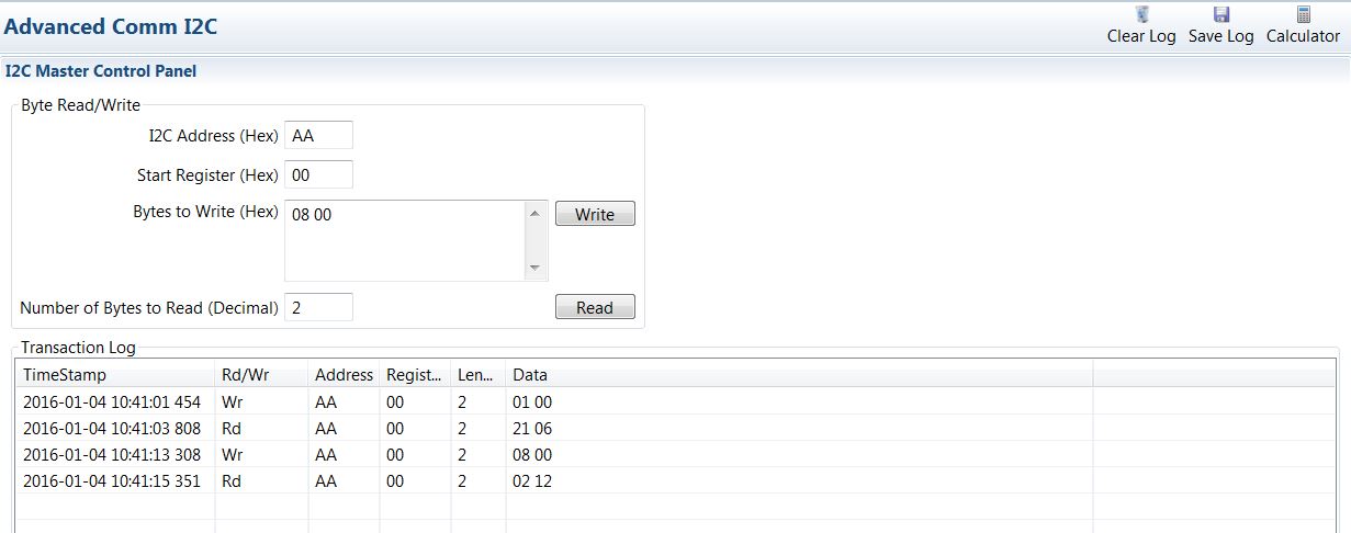

Starting I have successfully read the DEVICE_TYPE (0x0621) by I2C_write(0xAA,0x00,0x01) and I2C_read(0xAA,0x00).  Now I want to read the Chem_Type (0x08), so i did a I2C_write(0xAA,0x00,0x08) and I2C_read(0xAA,0x00) and it returns 0x1202.  Now if I try to do the two of them together one after the other, the first returns OK but the second just returns as the first.

    Thanx for the reply. When I mean to do them together I mean something like
    I2C_read(0xAA,0x00)
    I2C_read(0xAA,0x00)
    This way I get the correct Dev_Type , but the Chem_ID returns 0x0621 rather than 0x1202 as it does if i do it by itself.... im guessing time issue or the I2C... I put on some delay and didn't work and waited for the I2C to be freed before I send the next I2C command and still it persists. Any ideas?

  • Hi Georgios,
    I believe the problem is that you should be sending 0x0001 and 0x0008 for the commands not 0x01 and 0x08. Please see the following:
