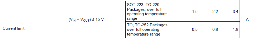

Customer have a question about LM317A internal short circuit current limit threshold. They can't see detail description about that. What is the over current protection threshold if customer use LM317A as a "12V~14V in / 9V out" power source? Thank you.
BR
Patrick
Hi Patrick,
The current limit is specified in the LM317A datasheet, under Electrical Characteristics.
http://www.ti.com/lit/ds/symlink/lm317a.pdf
Your voltage dropout is less than 15 V, so you will be looking at the current limit below.
