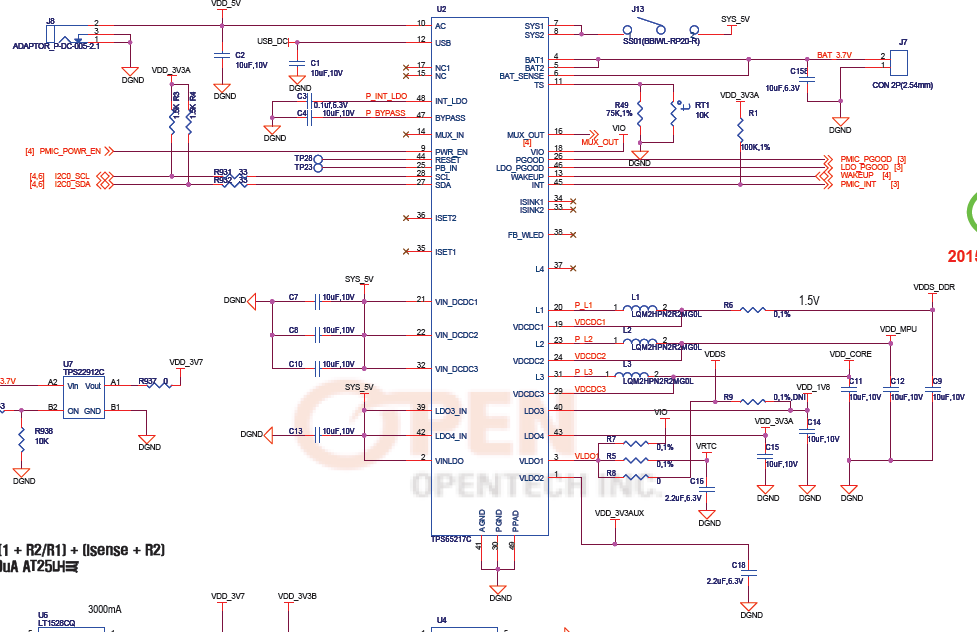

I want check the battery charge status.
MUX_OUT  is connected to the AIN4.
It was calculated charge status as follows:
  # cat /sys/bus/iio/devices/iio\:device0/in_voltage4_raw
  3108
  # cat /sys/bus/iio/devices/iio\:device0/scan_elements/in_voltage4_type
  le:u12/16>>0
  Vin = 3108 * 1.8 / (2^12 - 1)
        = 1.36
  charge = 1.36 * 100 / 1.8
              = 75%
Is it correct?
Battery is fully charged.
So it is normal that come to 100%.

  • Ahn,
    Let's confirm a few things first:
    Did you change the register 0x9h bits <2:0> to 001 to monitor the battery voltage, by default the MUX is disabled , and the output is HiZ?
    VBAT and VSYS are divided down by a factor of 1:3 to be compatible with input voltage range of the ADC that resides on the system host
    side. Did you divide down by 1:3?
    Janice
    register 0x09 bits <2:0> is 001
    How to setting the divide factor?
    Here is my i2c setting & schematic:
    # i2cdump -f -y -r 0x00-0x1e 0 0x24 b
               0    1     2    3     4    5     6    7     8    9     a    b    c    d     e    f
    00:  e2  3f   00  08  b1  80  b2  01  00  01  08  00  7f   0c  18  02
    10:  09  06  09  38  26  3f   7f   00  03  15  5f   32  40  20  00
