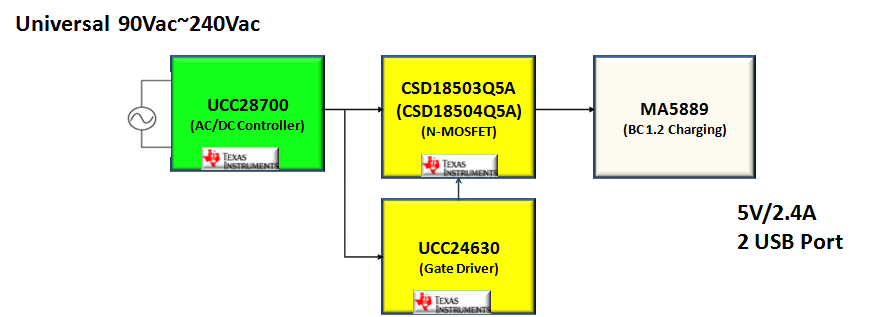

Does TI have recommend fast charging solutions BC 1.2?
Survey have fast charging solutions BC 1.2 function device replace MA5889, Can suggest me TI device to replace it ? thanks.

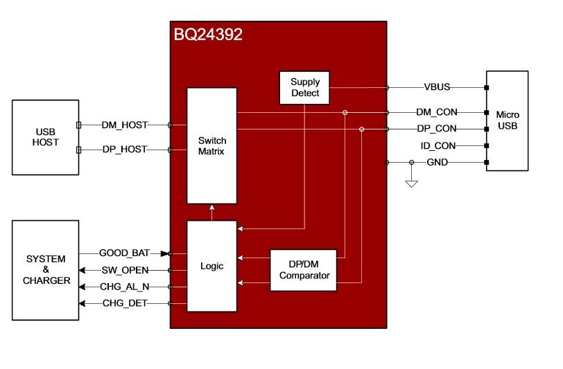

Thank you for the diagram. The BQ24392 does not provide the function you depict in the above diagram. The BQ24392 device sits behind the usb connector and will tell the system what type of charger was inserted.
I will move this thread to the power management forum to see if they can help you with your question as I don't think you are looking for a signal switch.
Thank you,
Adam
TPS2549Q1 can support 12W charge for applications where the USB 2.0 data function is required. TPS2514A can support 12W charge handshake w/o USB 2.0 data support.
