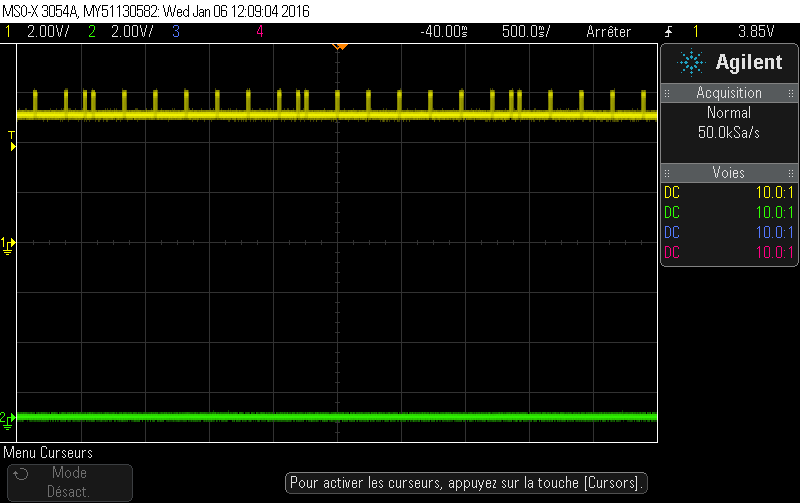

- I see this signal on RECT pin on BQ51013B, is it correct ?

    The figure you attached showing the "pulses" on the RECT pin are expected.  These are an indication of the communication from the RX to the TX.

    I did not see any current ripple on the included plot.  However, depending on many factors, the communication impact shown on the RECT pin can be seen on the OUT pin and therefore the output current.
