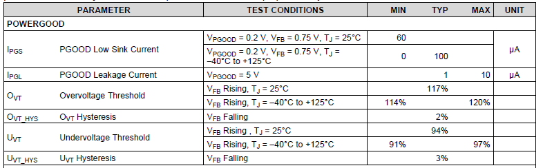

I am studying LM27402 for an application. Please refer to the following snapshot of Powergood section in the Electrical characteristics.
I understand how Uvt and Ovt relate to Powergood. Referring to the highlighted part, I could relate it to the text explanation for overvoltage but feel like they should be the reversed for undervoltage.
Is that correct?
