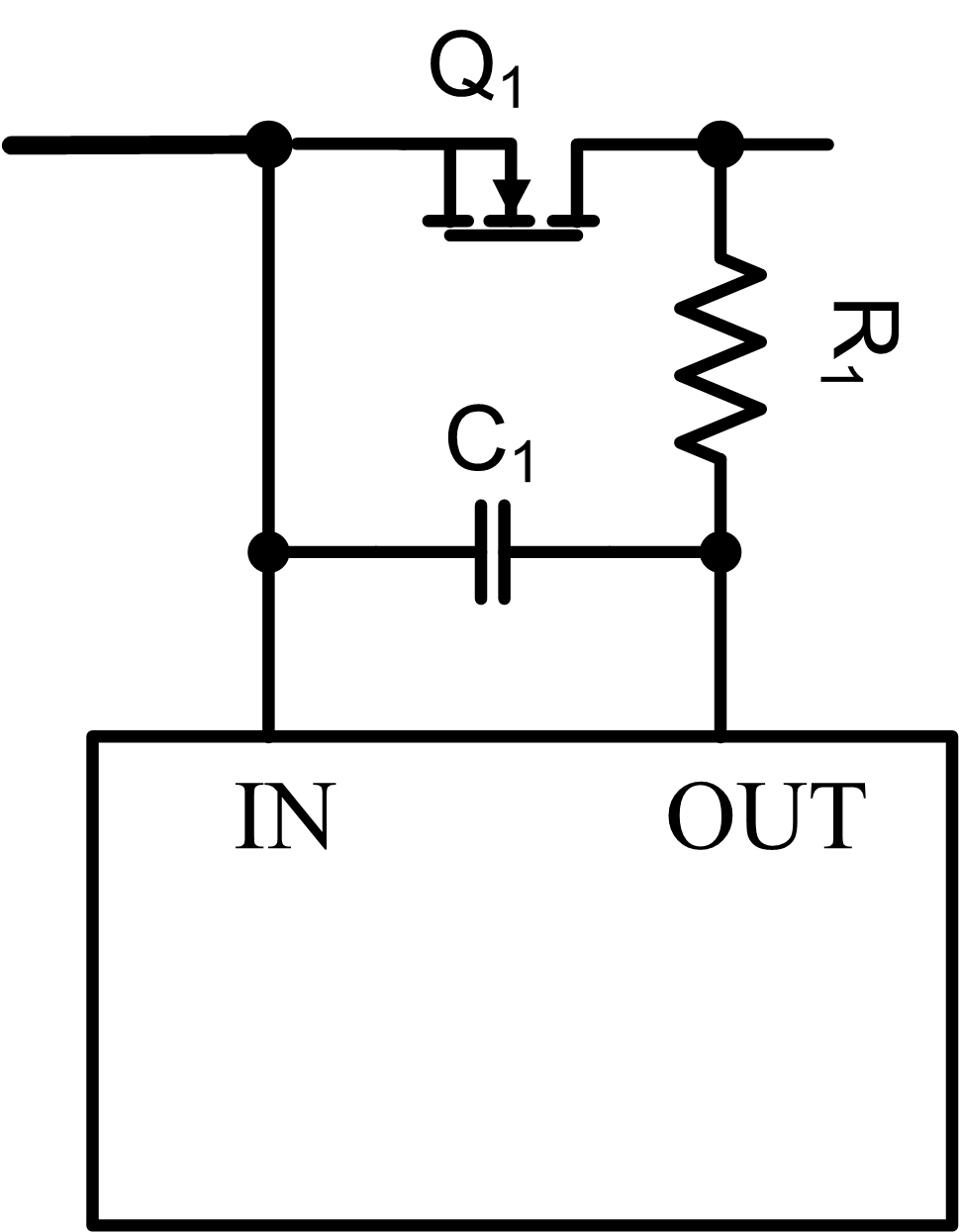

I have the LM5050-1 connected exactly as described in the datasheet, but am seeing very noisy output when the voltage goes above 17V.  Up to that point, it works and maintains ~20mv across the FET, but once I reach the 17V threshold, the roughly 2.6V gate drive drops to around 0.9V and has 2V of sawtooth noise at roughly 800 hz (the frequency is not stable) on it, and the voltage across the FET increases to roughly 0.5V.
I have tried the following:
I added the 100 ohm resistor and 0.1 cap going to Vs (Vout and Vs were originally tied together)
I added a 100 uF cap at the output
I changed the 0.1 uF cap on Vs to 4.7 uF (ceramic MLC)
Each of the changes improved things a bit, but none have really solved the issue.  This circuit has to operate at 27.6V (2 SLA batteries)
I am trying to change to this part from an LTC ideal diode controller, but so far its not looking all that promising.

  • Some additional thoughts on this issue:
    With an input of 27.6V (to match up with 2 SLA batteries), the gate waveform is a sawtooth, with the rising edge being slow and the falling edge being almost instantaneous. (I could send a screenshot of my scope if that would help)  This would lead me to believe that the problem is that the chip is momentarily detecting a reverse voltage condition and pulls the gate drive hard low, then the 'condition' goes away, so the gate voltage once again rises to try and turn the FET on, ...  That having been said, the extra filtering I put on (the 100 uF cap right at the output of the FET as well as additional filtering on Vs, should have resolved the problem.  I can't identify a reason for the issue.
    Could this be a defective lot of parts that are hyper-sensitive to noise?  The circuit has this problem with a load of about 200 mA as well as a 1-2 A load.  If the problem were noise, I would think either light loading or heaver loading would affect the way it works.  I have also tested it at roughly 15A (the FETs can handle in excess of 60A, and have <1mohm RdsON), but the FETS get very warm because the only thing conducting is the body diode.

    Overall the LM5050 features an extremely fast reverse current response (the spec is a 50ns response time). However, this can lead to nuisance shutdowns in systems with some level of noise.
    As a result, we would recommend adding some filtering to the sense lines themselves. Please refer to this image below:
    So this would create an RC filter which would help prevent nuisance trips due to noise.
    For example, you can try an R of 10ohm and C of 0.1uF to create 1us of filtering which may resolve all the nuisance trips.
    If 1us of filtering is too much for your system (you want a faster response time for reverse current shutdown), then you work down and decrease R and C.

  • Hi Duane,
    I saw your note at the bottom that the MOSFETs have <1mohm of Rds-on.
    Note that the LM5050 is a regulation mode ORing controller, not hysteric. A simplified explanation of the LM5050 regulation loop works like this:
    If Vsd > 22mV, then increase gate voltage
    If Vsd < 22mV, then decrease gate voltage
    If Vsd <-28mV, shut down gate immediately.
    So if the load is just 200mA for example and the Rds-on is 1mohm, then the Vsd would only be 0.2mV. The gate voltage will keep decreasing, therefore increasing the Rds-on, until the MOSFET is right on the verge of shutting off.
    I agree that at higher currents, the gate voltage will be higher and less prone to shutting off.
    Overall it may help to use a MOSFET with higher Rds-on. Section 8.1.1 of the datasheet discusses MOSFET selection. It depends on the current range of the application:
    www.ti.com/.../lm5050-1-q1.pdf
    If it is a 0-10A application, maybe a 5mohm to 10mohm MOSFET. If it is a 10A to 30A application, maybe a 3mohm.

  • Alex,
    This looks like a great solution.  I'll implement it, then post whether or not it fixed the problem.
    The FETs were chosen based on the circuit design constraints.  I am driving a motor to control a fire door, so it has to be able to supply >30A without excessive heating.  I have it set to trip at roughly 45A, although typical currents are much lower at around 17A or below.
    When the LM5050 is working, it controls the Vds very nicely with around 2.6V on the gates at low currents, going higher as the current increases.  The two FETs are used to achieve the higher reverse-breakdown voltage required, since the FETs breakdown is only 40V, and R117, 118 are used to force any reverse voltage to divide evenly.  Note - the schematic shows a LM5050-2 part, but the circuit is, in reality, designed for an LM5050-1, and both resistors should be 10K.  The circuit, as built, is correct.

  • Norbert,
    It worked great for me.  I experimented with a smaller cap, but a .01 caused it to oscillate again.  The challenge is that the more filtering you put in, the slower the reverse shutoff becomes, so I had to find the 'sweet spot' for my circuit.  Given the type of circuit you are driving, I would suspect that even more filtering will be required.  You could try something ridiculous (4.7 uF, which is readily available in MLC, for example), and if that stops the oscillation, then it becomes a matter of finding the smallest cap that will do the job.
    I also put in the 100 ohm and 0.1 cap on the power (Vs) pin.  If you are using a -2, then that option isn't available to you, but otherwise, it seems like cheap insurance.
