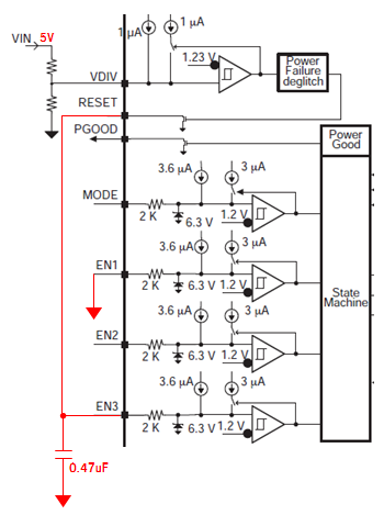

My customer has question about TPS65261-1.
Could you tell me about questoin?
[Question]
 My customer considers to design Automatic Power Sequencing under the following condition.
 (Buck2 -> Buck1 -> Buck3)
  - Case 1 -
  Vin=5V
  Mode: High (pull up to Vin)
  EN1: Low
  EN2: High (pull up to Vin)
  EN3: Open (pull up to internal current source)
  - Case 2 -
  Vin=5V
  Mode: High (pull up to V7V)
  EN1: Low
  EN2: High (pull up to V7V)
 In datasheet figure 29 shows sequence requirement between MODE and ENx.
 (EN1 and EN2 -> MODE -> EN3)
 Can the device use with Case 1 and Case 2?
 And which is better, Case 1 and Case 2?
