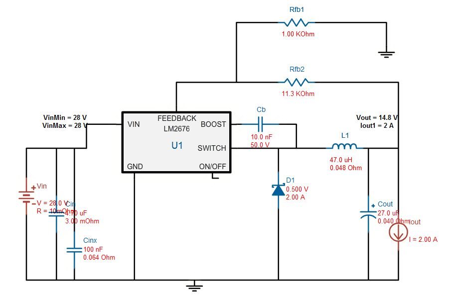

The data sheet has a workup of an example design (28 volt input to 14.8 volt, 2 A output). It uses a 68 uH inductor. With the same operating parameters, Webench's result uses a 33 uH inductor. Which, if either, should I believe?
