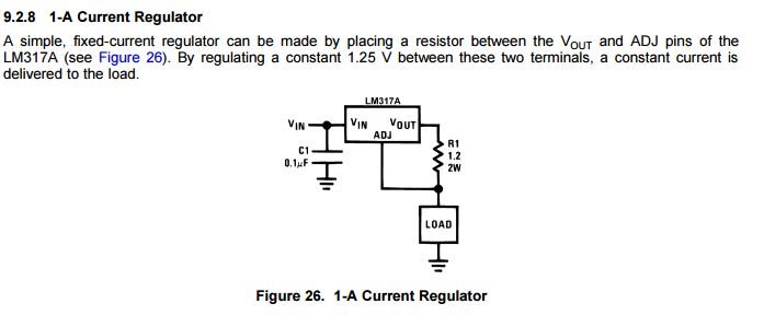

please help me to build Constant Current Source circuit:
Parametrs:
Vin = 40VDC
Rload change: from 20 to 40 Ohm
Iout constant = 1 A (and don't depending on load)
Best Regards
