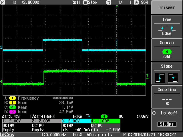

I investigated this problem with oscilloscope.
(please see attached screenshot).
Channel 1 - GPIO button,
channel 2 - PWR_EN pin of TPS65217 (PMIC_POWR_EN signal on schematic of Beaglebone White, rev.A6A),
channel 3 - PWR_LEDR signal,
channel 4 - SYS_5V signal.
As I understand, I have 1 second delay at least due to ALARM2 solution
(because I write into ALARM2_SECONDS_REG content of SECONDS_REG + 1 sec)
But I don't understand why PMIC is powered off after 2.52 sec delay.

    Channel 2 of screenshot is PWR_EN signal (It pulls down in the center of screen. Dotted vertical cursor marks this moment).
    Channel 3 is VLDO2 pin.
    Channel 4 is SYS pin (SYS1, SYS2), AC powering.
    Rails VLDO2 and others power down after 2.52 sec delay (second dotted cursor).
    Why?
    What is reason of this delay?
    Can I reduce this delay (ideally to switch off immediately)?
    Oleg.

    I followed your recommendation and used in my algo SEQDWN bit only (without OFF bit). On new attached screenshot (seqdwn_only.png):
    channel 3 (blue) - PWR_EN,
    channel 4 (green) - rail DCDC3 (VDD_CORE).
    Delay from PWR_EN low to DCDC3 low is 3.5 sec.
    But in this mode PMIC & am3359 is powered off, but after 1 sec is powered on and continuosly restarts with 6 sec period.
    So I tried to set OFF bit only (without SEQDWN bit). Results you can see on next screenshot (off_only_1.png)
    Channels assignment is the same.
    Delay is 3.64 sec on this screenshot.
    On the last screenshot (off_only_2.png) I pulled down PWR_EN signal later and we have delay 2.42 sec.
    But in both cases 5 seconds is elapsed from power-up moment to power-down moment.
    It looks like PMIC is busy after power-up and can't begin powering off procedure before 5 seconds delay.
    What does it mean? What is the magic 5s delay? It isn't mentioned in datasheet.
