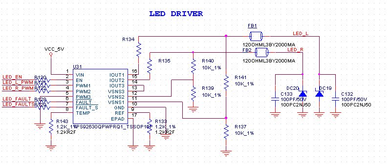

I have a question about TPS92630-Q1 Fault pin's active as below:
How do we have fault signal active?
I try to remove the load LED, but I still cannot get fault signal!
Below is the schematic:

    I found the reason that why we cannot get the open load signal.
    The problem is from DC20 and DC19 TVS diode.
    If we put the TVS diode at the Iout path then we cannot get the fault signal active even we remove the LED module.
    This may have the ESD protection issue, does TI have any suggestion for this?
    By the way, if the Vin is 12V then we will get the Iout voltage over 12V or it will be less than 12V in maximum output current?
    Thanks !

    May I know the TVS voltage of DC20 and DC19? What i the LED number and forward voltage?
    Only when Vin-Vout <100mV, there will be a open fault on the TPS92630-Q1.
    Actually if the TVS voltage is low, the current can flow through the TVS directly. So the TVS will act as the LED load.
    Because TPS92630-Q1 is a linear regulator, so the output voltage will be smaller than the input voltage all the time. Because there must be a voltage drop between VIN and IOUT to maintain the output current.

    VISHAY (VESD05A1B-HD1-GS08) 6.8V TVS & LED is 3V forward voltage the number is one.
