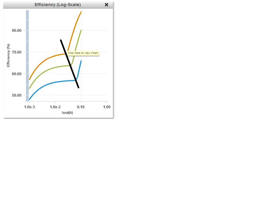

Our customer evaluating LM43603 for RF power amp supply.
They want to use this with CCM/DCM mode(=do not enter PFM mode) in all output current situation, from 100mA to 2A.
In their evaluation by EVM with 100mA to 2.5A load, it operates with PFM mode when the current lower than 250mA.
(Vin=24V+/-10%,  Vout=3.3V, Fsw=1MHz)
The customer can change inductor and other external components, but we don't know the way to optimize them.
Can we check the relation between output current and switching mode with WEBENCH or any tool ?
