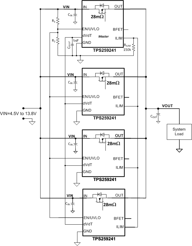

I have an application where I want to limit the current to 18A. Is there a way I could do that with TPS24751 ?
Nithin
Hi Nithin,
We have not yet tested TPS24751 eFuse parallel operation. It may be possible with some circuit modifications.
TPS259241 is tested for parallel operation of four devices. Here is the schematic.
Please note, the circuit must be tested to a satisfactory level before using it in production.
