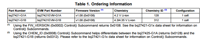

I see we have www.ti.com/tool/BQ27421EVM-G1A and www.ti.com/tool/BQ27421EVM-G1B , but I am not seeing what the difference is between the two. Please describe what I might be missing in determining which one would be best for my test environment.
