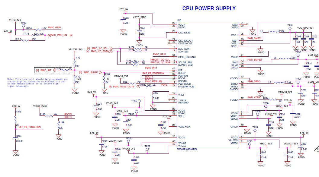

I am using TPS65910A3A1 PMIC for AM3352ZCE processor.
but as i provide 5V input to PMIC its not being power up and not generating any voltages. also VREF is 0V.
so what may be problem?

Hi Brijesh,
Is there a push-button that I cannot see? PWRON is an active-low start condition, and without a user asserting this pin low, PWRHOLD should instead be connected to +5V. As is, VAUX33 will not have a reason to be enabled and will not assert PWRHOLD.
