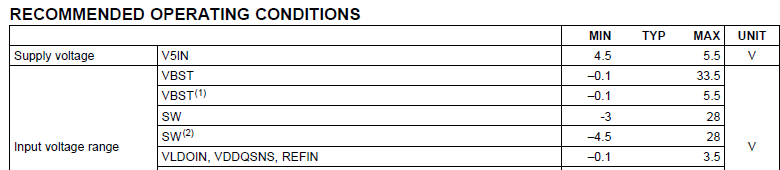

HI  Sir
about TPS51216 VBST pin, from SW to VBST maximum is 5.5V, and maximum rating is 6V, i think the voltage rating is too low,
our customer measured the voltage from SW to VBST is 6.5V(boot resistor= 2.2ohm, and Cboot= 0.1uF),
 Can controller tolerance high voltage @less n second?
or we just can inceasing Rboot, Cboot?
