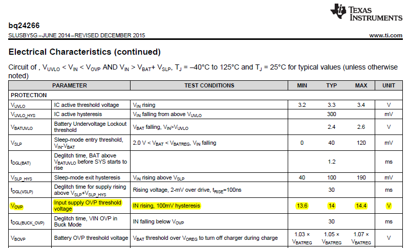

On page 10 in the datasheet under the Electrical Characteristics table(below), VOVP is nominally 14V.  If the part is supposedly rated for "30-V Standalone Single-Input" then when the OVP is triggered, the PWM will be shut-off.

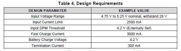

The table above shows the part can "withstand 28 V."
So realistically, the part can only be used at max 14V. Can someone please clarify?
