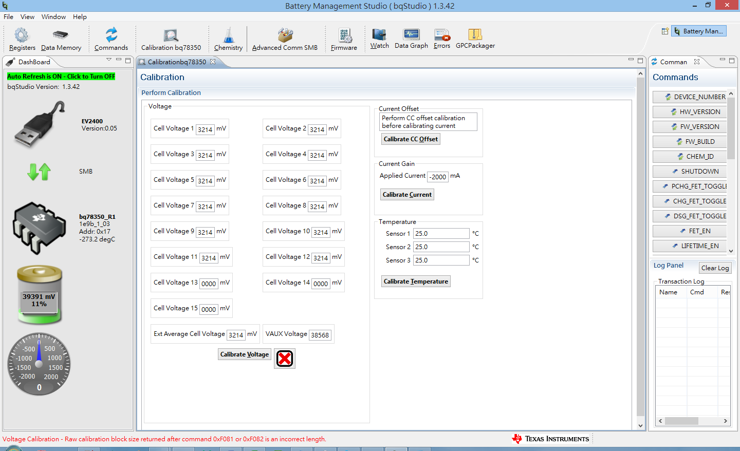

I'm having trouble with having some errors on perform calibration. 0xF081 & 0XF082
GUI & Firmware is the latest version
THANK YOU VERY MUCH!!!!
Kevin,
The bq78350 bqz file needs to be updated to fix the calibration problem. It will be fixed in the next bqStudio release, but here is a copy that should fix the problem. Place it in the config directory.
C:\ti\BatteryManagementStudio\config
https://e2e.ti.com/cfs-file/__key/communityserver-discussions-components-files/196/3644.1E9B_5F00_1_5F00_03_2D00_bq78350_5F00_R1.bqz
