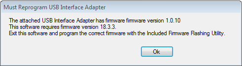

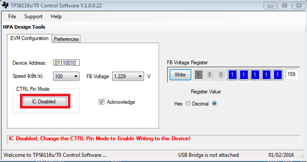

I just got a TPS61170EVM-280, but when I try to use the TPS6116x/70x Control Software with the USB-TO-GPIO adapter box, I can't seem to adjust the output voltage of the converter.

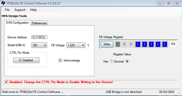

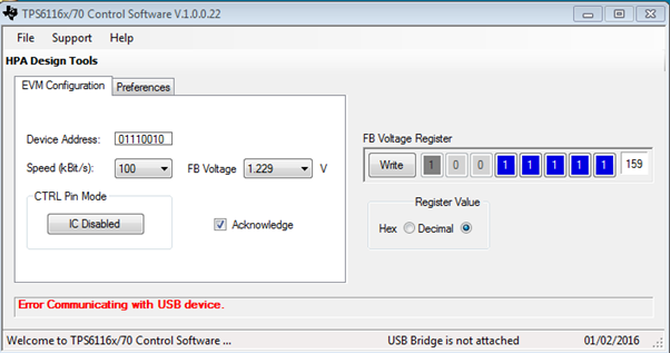

The software gives messages in red saying “IC Disabled” or "Error Communicating with USB device".
CTRL Pin Mode always says “IC Disabled”.
The USB driver seems to have installed properly, with Windows 7 saying it's ready to use.
Does this look like a fault with the USB interface box? Or is there some magic sequence to switching things on?
