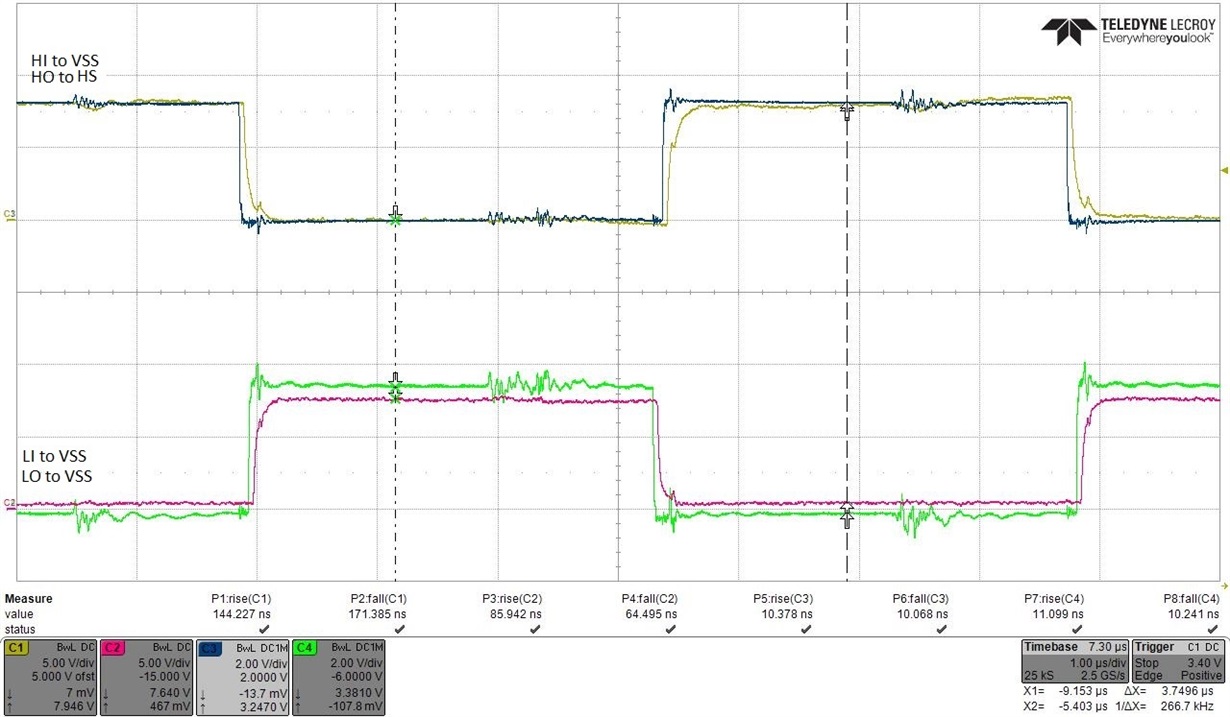

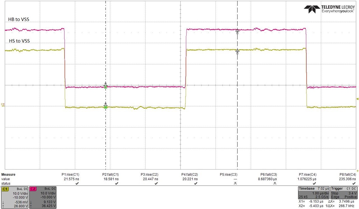

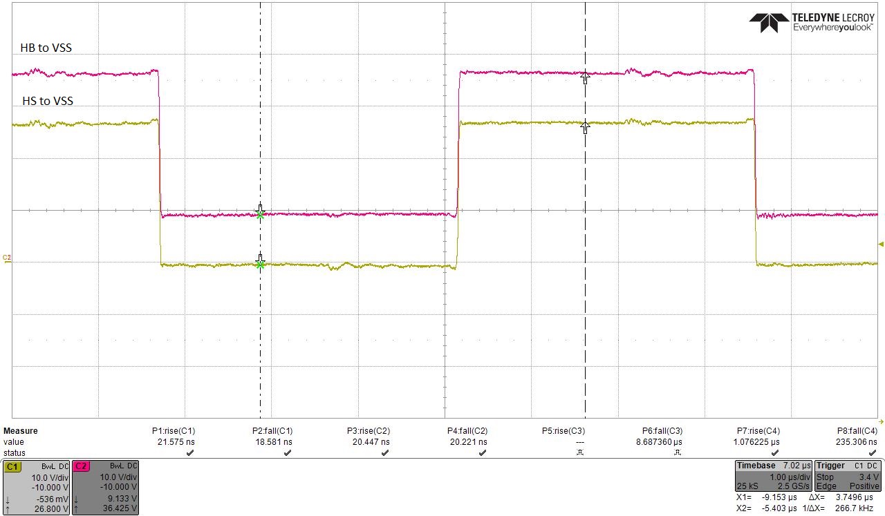

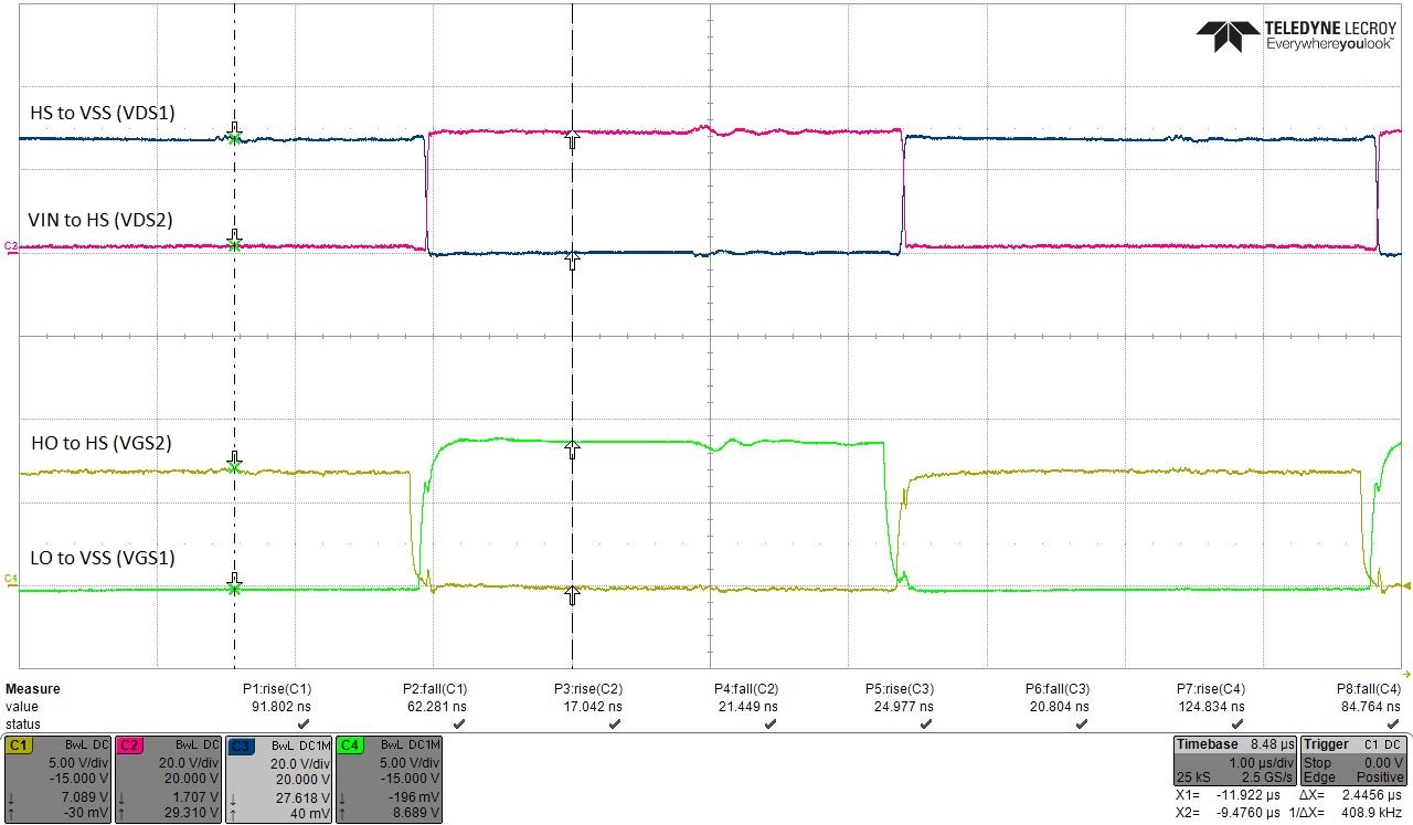

  • Hi Ryan,
    Thanks for sharing the waveforms.
    I noticed that there is bandwidth limit on all of the waveforms. It is generally a good idea to take waveforms without bandwidth limit and with single ended probe.
    Differential probes do not have much of bandwidth and it is difficult to capture spikes using them.
    From the last waveform, it seems that there is some cross conduction between high side and low side MOSFET.
    I believe this waveform is taken at steady state. It is possible that the dead time between high side and low side gate drive is not enough to prevent shoot-through in any and all operating conditions.
