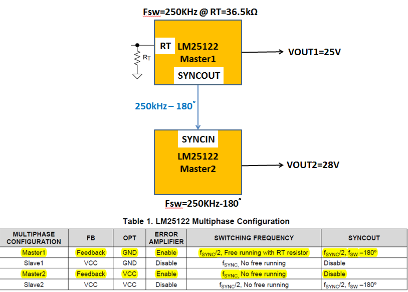

Our customer would like to connect “Master1” and “Master2”.
Because, they would like to operate each device using frequency of Master1 and to set other output voltage.
Could you please let us know if you have any concerns about following circuit?
