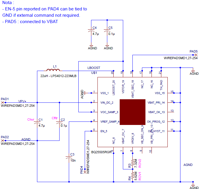

I had a customer who selecting BQ25505 for a solar battery charger for smart watch. Since they only had one small battery from the system, so that they would like to know if their system can connect to the battery directly (Vbatsec) instead of FET after the (Vstor), kindly confirm if it is OK.

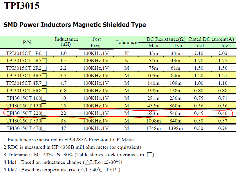

Also they would like to confirm with us if they can use below coil for the L1.
