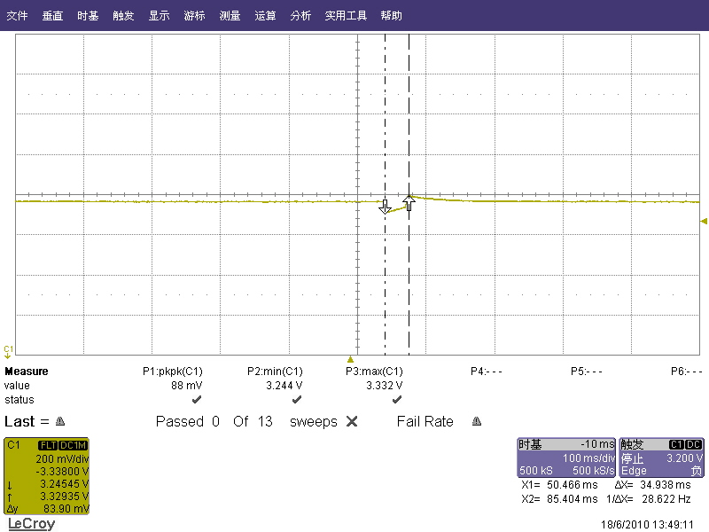

                                                                                                                     Picture 1
    1, Picture 1 is Vcc's wave. There is a wavefore. the Peak to peak value is 88mV..Coulde this affect the RM?

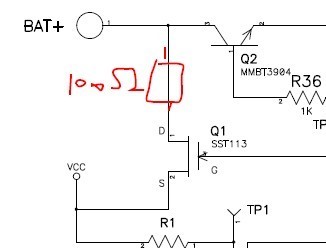

    Another:
      1,Are that JFET's D S  inner-changeable?
      2. I connect a 100ohm resistor to the Q1.
         Does that have any effect to bq2060?

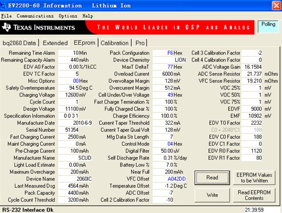

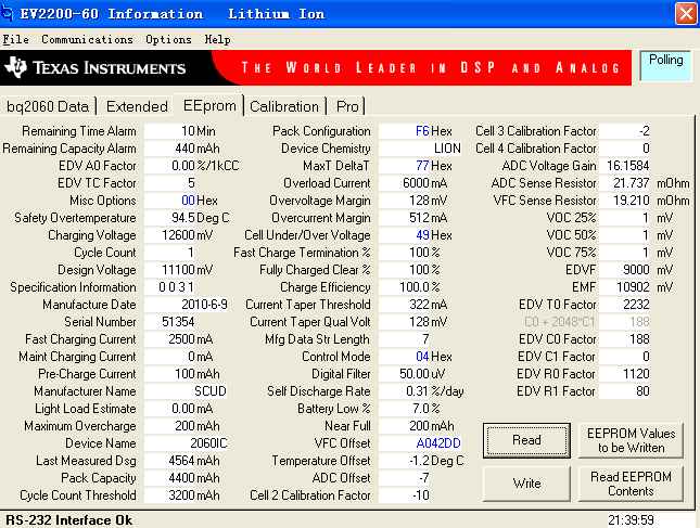

    3. Read the SBS pack status"EINT", This bit is set while there is no current flow arross the sense resistors..The EEPROM screenshot is as below.
      I have try recalicated the voltage,current,VFC. But RM still may drops abnormally..
