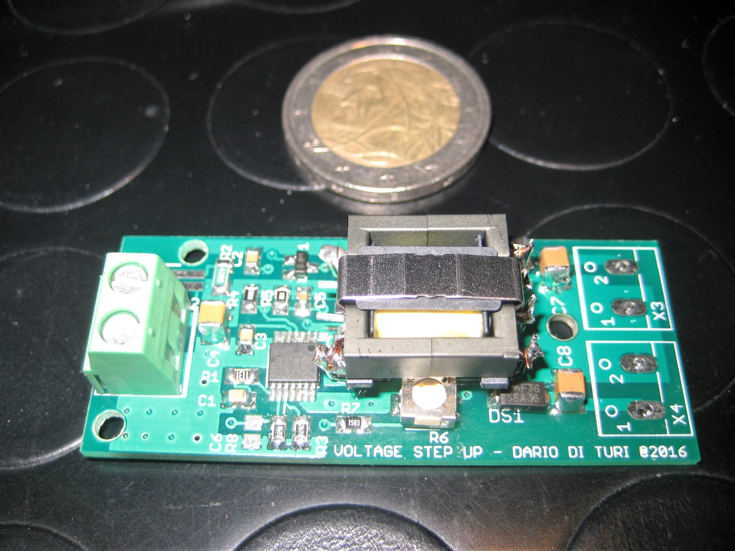

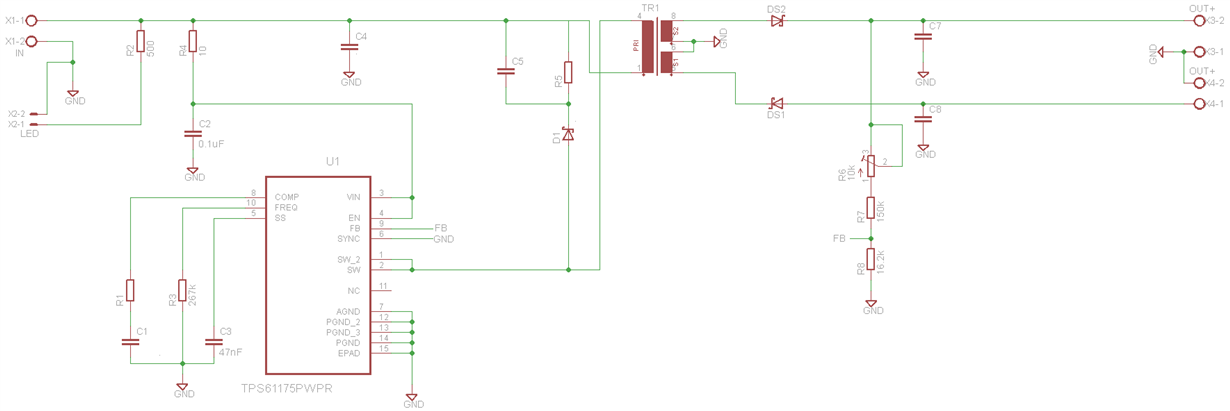

i need two voltage rail, +13V and -13V with 150mA current (300mA total).
I have  an input voltage from 4 to 6V (four battery AA)
I want to use a TPS61175 in flyback configuration to derive two rails.
I looked AN SLYT323 "Using a portable-power boost converter in an isolated flyback application" but I do not understand how to calculate the primary inductance.
In the example of AN the primary inductance is 1,2uH. (the datasheet recommends inductance from 4.7 to 47uH).
