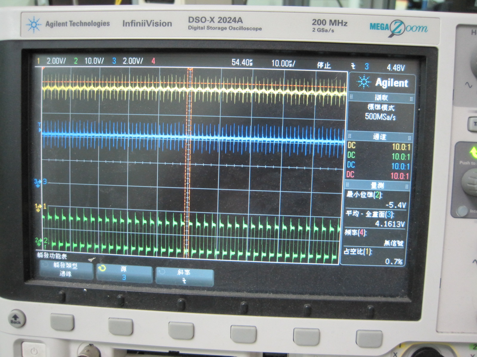

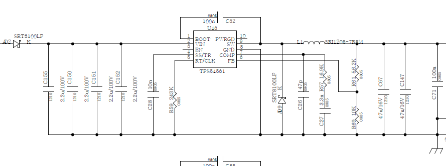

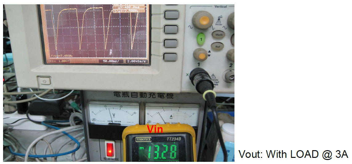

I have a project use TPS54661, Vin=6~50V, Vout=5.3V, Iout=3A, and had a heavy load issue, when I used under 15Vin and Iout 3A caused Vout unstable.The waveform as below.
What do I need to modify the circuit , please advise?

Hi Bruce,
I suspect the current limit of the power supply. When you reduce the input voltage, it draws more current to maintain the output power.
Can you check the current limit set on your power supply and make sure that it is not the cause.
