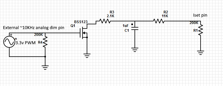

In this application, it would be desirable to have different current settings for strobing/scanning than regular PWM.
Scanning/strobing can have a maximum effective duty cycle of 10 or 15%, so the backliight current is often 2-3x the regular mode.
I know that the TPS61196 has a 120mA short-circuit-detection on the Iset pin, so some care would be needed (R2 below), but other than this, can the Iset pin tolerate more than a simple set resistor attached to the pin?  Here is what I am considering to get the full 25mA-400mA per channel range:
For this chip, a similar circuit would need to be applied to IFBV (R10 in datasheet).
My questions to you:
Can TPS61196 tolerate this?
Can TPS61199 tolerate this (modified for it's own anti-short protection?)?
