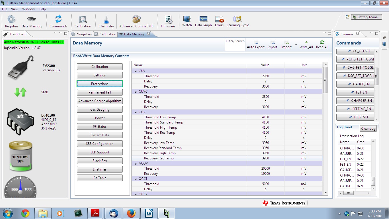

    but i am confused during updating DA configuration register  ( Please confirm   Data memory is same as DA configuration register).
    Which parameter is for cell and which parameter for battery pack..
    Calibration  : Is for cell or battery pack
    Setting : ??
    Protection : Should i Update this section  as per cell value or battery pack value ???
    Permanent fail : Should i Update this section  as per cell value or battery pack value ???
    Advance charge algorithm:Should i Update this section  as per cell value or battery pack value ???
    Gas gauging :Should i Update this section  as per cell value or battery pack value ???
    for more details please see attached image .
    Please help in this regards..
    Sachin Ghorse
  • Most parameters are set at the cell level. There are a few exceptions.

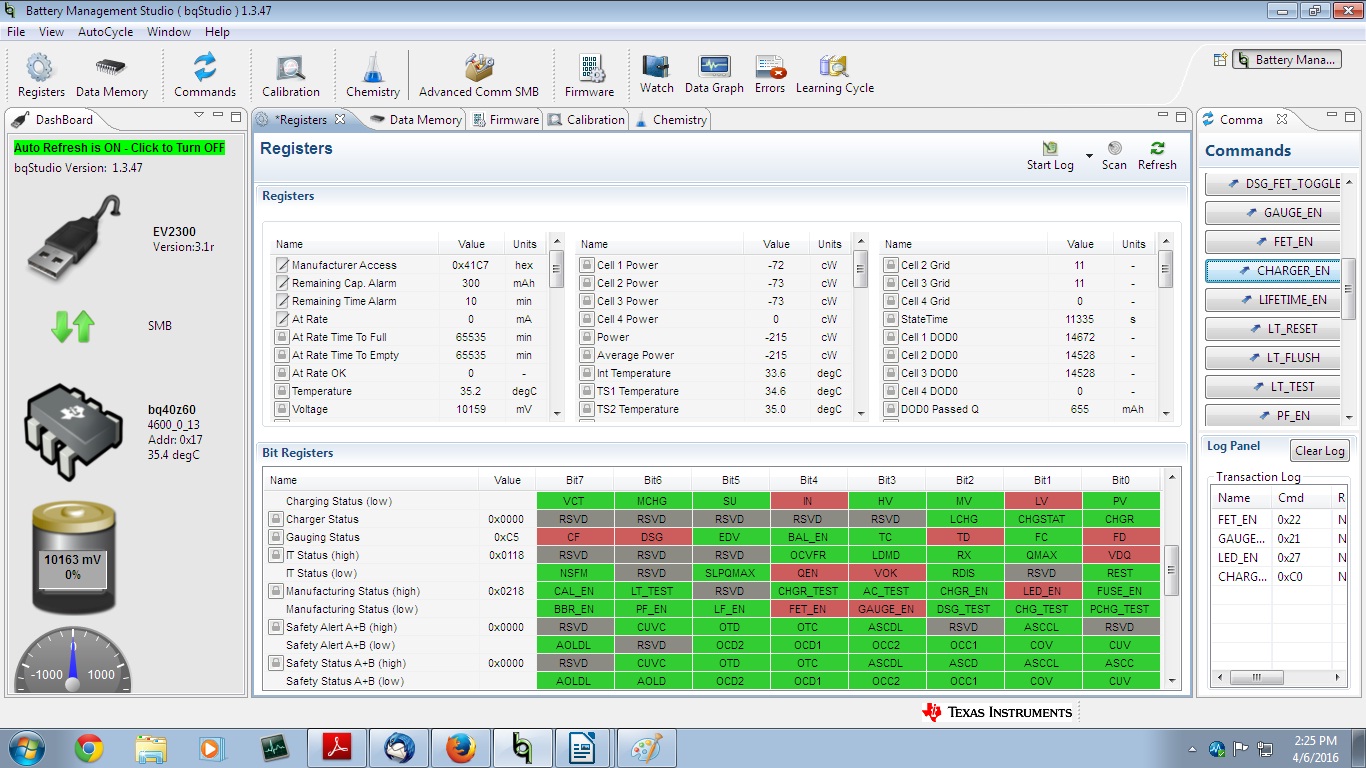

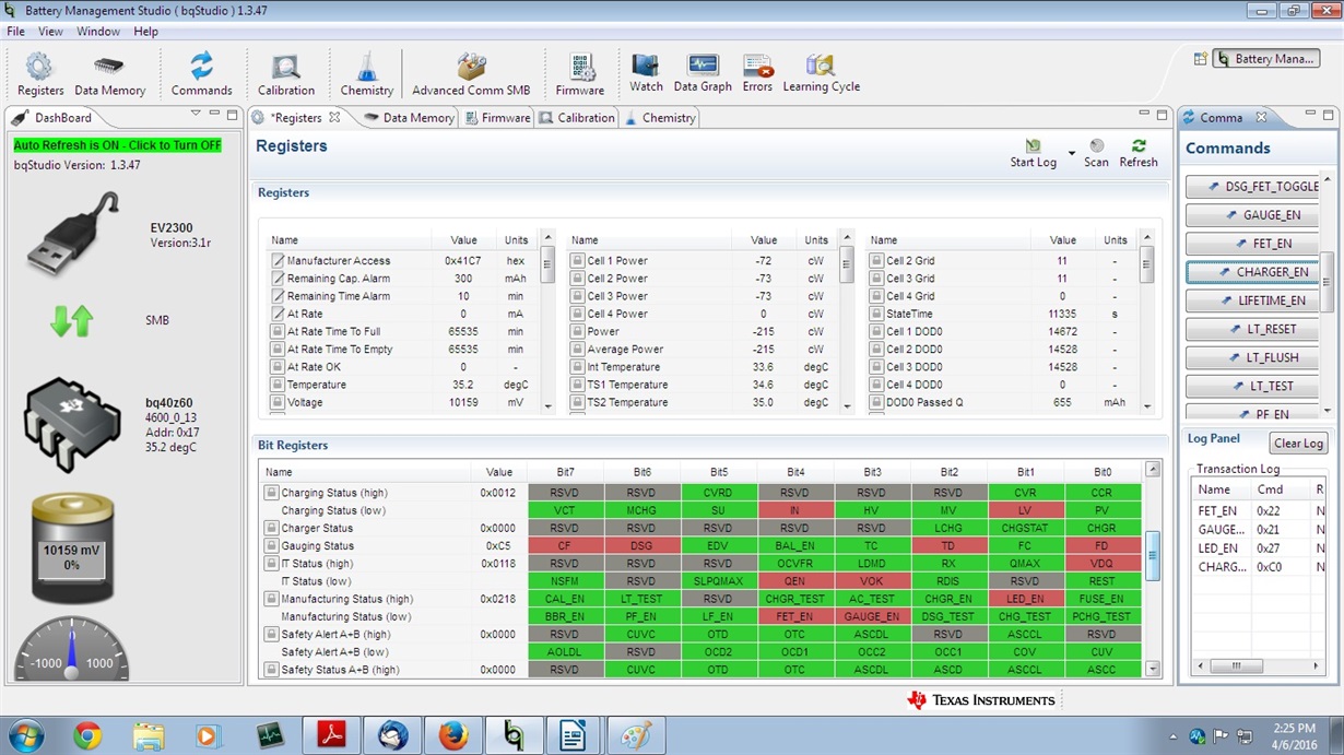

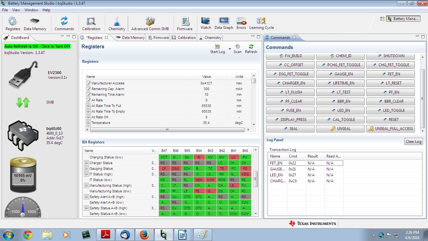

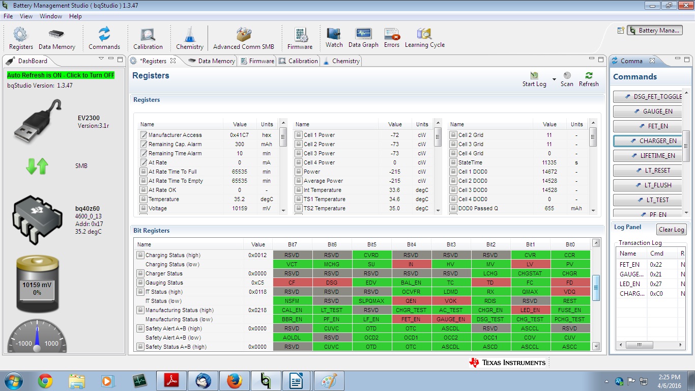

  • Dear Tom ,
    Thank you for your reply..
    As per your dictation i had try to program EVMbq40z60 as per following process.
    1) I had connect EVM and EV2300 as per User Guide SLUUB71.
    2) I had done dump default  firmware , voltage calibration and update chem id from data base (Use Samsung ICR18650-26H).
    3) I had set jumper at 3 cell configuration.
    4) Set protection value as per cell and battery configuration.
    5) Send Gauge_EN command.
    I had observe..
    1) Discharge process start , but RDIS flag is in green color i.e. 0  and VOK flag is in red color i.e. 1. How it is possible ? As per my knowledge  during discharge process RDIS flag should be set i.e.1.
    2) During discharge process i observe remaining battery capacity is zero but , discharging process going on.
    3) I had try to charge the battery but charging in not enabled
    for more details here i had attached log file and screenshot.
    Sachin Ghorse462016v2.log   4152.462016v2.log   3288.462016v2.log

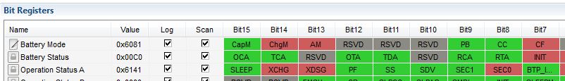

  • RDIS should be green and VOK should be red after you issue an GAUGE_EN. Can you export an srec and attach it? I can check to see why the pack will not charge.

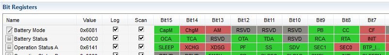

  • Dear Tom ,
    Good day...

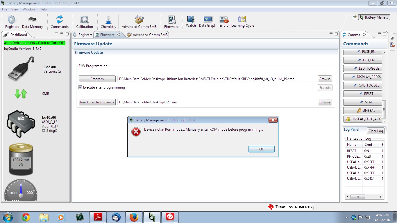

    We occurred below mention error during damp default SREC file , please find attached image for reference.
    Kindly help as early as possible
  • Please verify that the gauge is not sealed. This is usually the reason that it will not enter ROM mode. The SEC1 and SEC0 flags should be set like this if it is unsealed and in full access mode.
