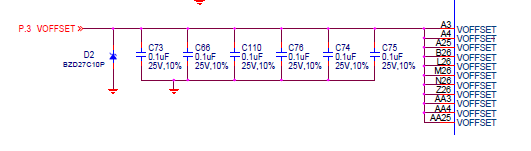

Please let me know about TPS65145 in DLP6500 reference circuit.
【Background】
・Reference schematic is attached.  (Page-3)
2511979B_LCR6500_DMDBOARD_P65_1080P_S600_CSTACK_FLEX_CONN (3).pdf
・Question point is R30, R34, and R38
【Question】
①If TPS65145 use on the maximum Iout of the spec,
  R30,R34,R38 will exceed maxim rating of Power Loss.
  (Ploss=I2R, these results were over 2W)
  Are these circuit no ploblem?
②I think that this reference made for low Iout case.
  (For example, SW:150mA, OUT3 and DRV:20mA)
  Is this thinking correct?
③If incorrect, please let me know about backgroound of
  "the reason of Resister value:No problem"
Satoshi
  • Hello Satoshi,
    In these circuits, the current starts flowing in R3x when the power supply turns off until  the different output capacitors are discharged. This lasts a few milliseconds. Therefore the average power dissipated in these resistors is less than the power rating of 2W you gave.

    ・About TPS65145 output line (Voffset), page-5 connecting zener diode "BZD27C10P".
    ・Is zener diode make protection circuit, is it correct?
    ・If correct, I think that zener diode can't protect perfectly.
     ・Reason
      BZD27C10P⇒VZ:9.4V~10.6V
      DLP6500⇒Voffset range:8.25V~8.75V (Maxim rating:9V)
     ⇒Protection can't because VZ > Voffset.
      Is zenerhave any other purpose?
    Satoshi

  • Hi Satoshi-san,
    Zener is meant for protection purpose only.
    Protection can't because VZ > Voffset;
    >> There is 9.4V - 8.75V = 0.65V of extra margin the device is exposed to; which is okay. If you look at the next lower-voltage Zener diode the operating range is 8.5V - 9.6V; this falls on the DMD operating range, we don't want the Zener diode to enter protection mode under normal DMD operating condition, this is the reason why we end up selecting higher voltage zener.
