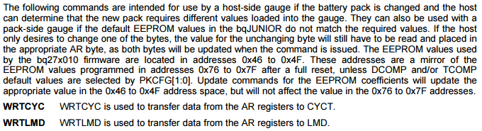

    Is possible to program EEPROM location by writing into RAM location(0x46 - 0x4F) directly, without programming into EEPROM (0x76 - 0x7F)??
    In http://www.ti.com/lit/an/slua414/slua414.pdf datasheet, page no 2, 2nd paragraph said that we can programmed into RAM location(0x46 - 0x4F), the new co-efficient in ram location will be copied to the EEPROM (0x76 - 0x7F).
  • Hi Fernando,
    Without programming into EEPROM Can we change RAM address 0x46 to 0x4F. If possible please tell me how.
    Am waiting for your answer for my Previous question, Please answer ASAP.
  • Hello Yashavanth,
    It is possible to write to RAM without programming the EEPROM.
    Page 13-14 of the bq27010 datasheet lists the commands you can use to indirectly update RAM registers without programming the EEPROM.
    In order to update ILMD in RAM location 0x46, the value can't be written directly to register 0x46. You can first write the desired value to the AR register, then use WRTLMD command to transfer the value to LMD.
    You can also use WNACCI to initialize NAC to some initial value. Otherwise, NAC will always initialize to 0 and stay there until a learning cycle has completed.
    Thank you.

  • Hi yashvanth
    It is not possible to write those RAM register.If you want to modify the value you have only one option AR register only.
    Your Design capacity value is 0x07
    First write the value in IMLD Register.The IMLD is updated by UPDC bit in the Mode register.
    As per the configuring EEPROM datasheet your LMD value is 0x700.
    so write LMD value using WRTLMD
    and then write NAC value also equal to 0x700
    For EDVF  update  use the  UPDC bit
    and for EDV1 use the bit UPEDV1......

    Thanks Fernando for your quick response.  Yes,The log I have attached is for full cycle.  We are facing issue in RSOC % and that is the reason we are seeking your help fixing this issue.  These are inputs from our end:
    1> We are using 340mah battery and default bq27210 is not supporting this capacity in our board.
    2> We updated the values of ILMD ,EDv1 and EDVF to RAM locations 0x76,0x77 and 0x78 respectively with no 21v power supply connection.
    3> On Full reset/Partial reset as mentioned in Datasheet, the same values were not updated to 0x46-0x4f locations.
    4> We also tried updating NAC,LMD values using AR registers but NAC did not change (neither decrease nor increase) with respect to battery charge.
    So we planned to share part of the source code performing the same actions,can you please review on the same and let me know ?
    Your NAC and LMD values are initialized to 319.87mAh, which are fine for a 340mAh cell.
    Do you have a log showing a cycle discharging the cell? In other words, with a discharge current flowing through the sense resistor from fully charged to completely discharged?
    Also, why is your battery voltage 2.4V? A Li-ion cell should never be discharged this low, it will force an internal chemical reaction that can permanently damaged the cell and cause capacity to be lost. Are you initializing the NAC value to the full capacity when the voltage is 2.4V?
  • FYI we updating NAC at 2.4v is that problem? if so what's your suggestion for it?
    Yashavanth.
    Any particular reason why your cell is discharged to 2.4V? Li-ion and polymer cells shouldn't be discharged this low? Have you tried cycling the cell from full to empty? If so, do you have a log showing this? The log provided earlier didn't have any current information.
