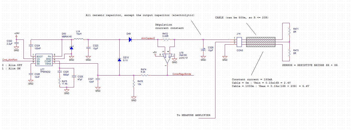

I need to power a sensor (resistive Wheatstone bridge 2x R = 8 ohms) with a constant current I = 150mA.
I use a TPS54232 converter, with a current monitor INA193 : The INA193 measure the current, and its output is injected in the reference pin of the TPS54232.
The output is not stable (Ring Vpp = 0.5V).
I think I haven’t choose the right compensation component, because the feedback is an INA193, I was not sure the datasheet calculation for the compensation components apply. So I use the “standard” component values from the datasheet, and decided to manufacture the prototypes.

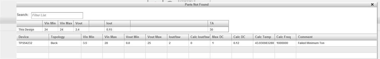

 Texas WEBENCH simulator can’t perform the simulation, and the error message is “failed minimum Ton”. I don't understand this error.
Could you help me to fix this problem?
The characteristics of my design are :
Vin =24V +/-10%.
Iout = 150mA.
Vout = 2.4 to 5.4V (depending the sensor + cable resistance )
 My schematic :
Webench simulation failed....
