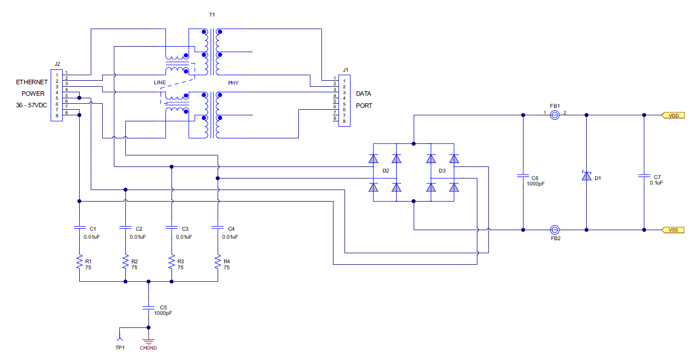

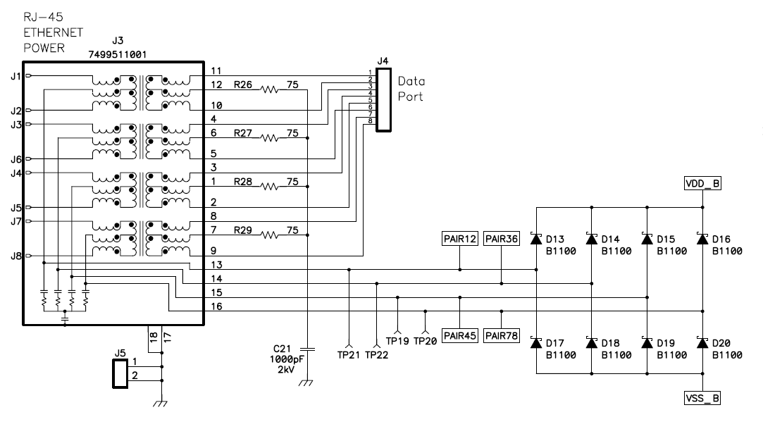

  • Hi Darwin,
    Can I use the J2 (Normal RJ45 Connector, Jack, Modular, 8 POS) and T1 (ETH1-230LD from Coilcraft) in “Pic 1” to replace the J3 (7499511001 from Wurth Electronics) in “Pic 2”.
    Both connection were copied from TI reference design.
    One is from the TPS23756 12V 15W output solution and the other is from TPS23754EVM-383 EVM.
    Thanks.
  • Hi Shaun,
    This mostly depends on the data rate of your application. For 10/100BASET applications, you do what is shown in the TPS23756 reference design. For 1000BASET applications, you can do some form of the TPS23754EVM-383. For example TPS2379EVM below does two separate data transformers.
