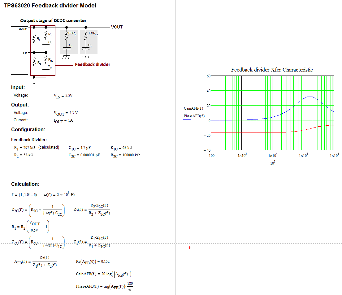

  • Yes you can improve the phase margin with the feedback network.
    Attached you can find a screenshot of the calculation I did in Mathcad to plot the phase and gain of the feedback network. You can use these calculations to play around with the values and see how each parameter influences on the phase. It can help you to find the right combination of components for you load profile.
    I can send you the Mathcad file if you want.

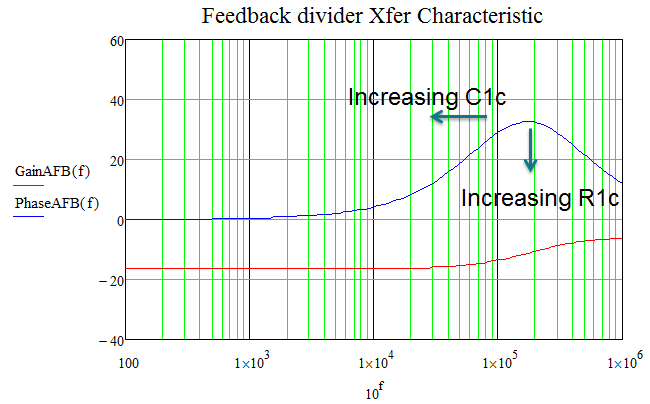

  •  These values strongly depend on your load profile and the desired transient behavior you need.
    I would suggest you to start with the values of the datasheet R=68k and C=4.7pF, then increase or decrease the values of the components, according to your specifications for load transient behavior.
    Normally increasing the value of the capacitor moves the crossover frequency down and therefor increases in phase margin and consequently the transient behavior. But you have to test it and see which values are the best for your circuit.
    When you want to modify components' values in the feedback divider, first use the mathcad file to have an idea on how they influence your phase margin.

  • I don't know any other free software to open this file.
    I already posted a picture of this Mathcad file to show you the calculations, so that you could understand how the parameters influence.
    Here is an overview on how the parameters influence you loop characteristics (For this case we can neglegate C2c and R2C)
    Either you could use any other software that supports formal calculations and complex numbers you use the equations I gave you. Or you could start your design with the same values given in the datasheet for the feedforward circuit
    For 3,7Vout  you could use R1=339kohm, R2=53kohm, C1c=4.7pF  and R1c=63kohm (graph you see above is given for these values)
    After measuring your circuit performance with these values first, I can help you optimize them if needed.
