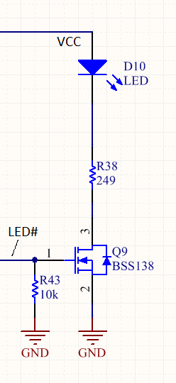

However, there is no visible (or measurable!) activity at any of the LED# pins. In our particular design, we are controlling the LEDs by driving a small FET to switch on the LEDs (to alleviate the LED# pins from having to drive the LEDs themselves - is this strictly necessary though?)
We proceeded to physically remove the pull-down resistor and the FET in this case, leaving the pin completely isolated. Using a multi-meter we observed that the voltage on the isolated pin remained 0 V during a button press.

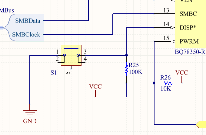

The schematic for how we connected the DISP button to the BQ78350-R1 (which I believe is correct?) is shown in the screenshot below:
  *GND is connected to VSS

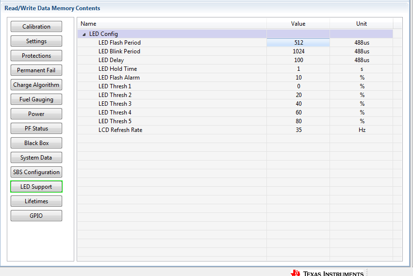

For good measure, here is a screenshot of the LED Support settings:
I've been doing a good amount of checking the Technical Reference, the Datasheet and the settings in BQstudio to see if there's something I've been missing all this time. I have not been able to find it.
