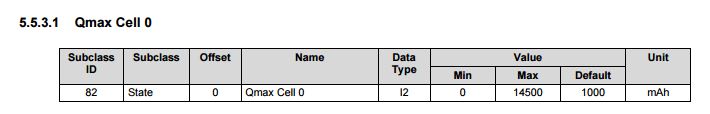

  • Hello Fernand-san
    Could you please give me a little more advice on this?
    How does QMAX is written at battery pack?
    Is it mAh?
    Is there a specific formula for get rough estimate of the TTF?
    Manabu Ito
  • Hello Manabu-san,
    QMAX is updated after a learning cycle is done and during normal operation of the system.
    Section 5.5.3.1 of the bq27542-g1 TRM includes the memory location of QMAX.
    They can try obtaining an estimate of TTF using (QMAX - PassedCharge)/AverageCurrent while charging. Again, this is not an official supported way to obtain an accurate TTF, it would be an estimate. This doesn't include taper time.
