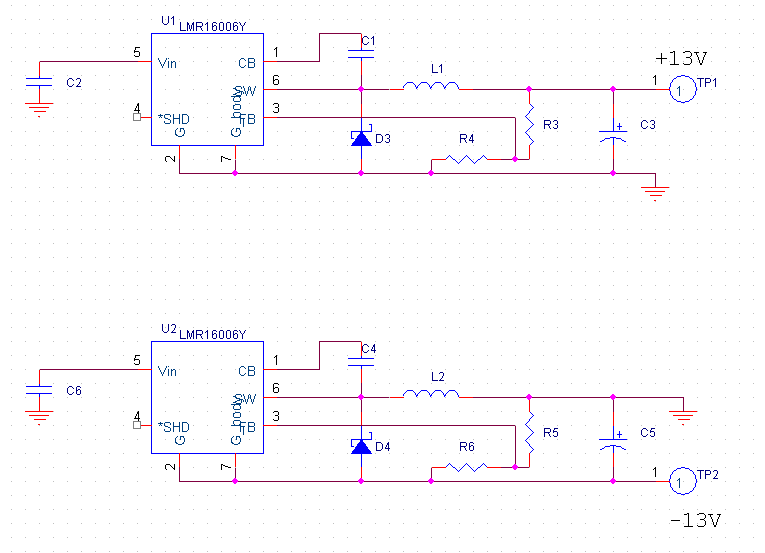

I am using two LMR16006Y to create a dual-output power supply as shown in image below.
I wish to enable/disable the regulators with a 0-5V signal. For the +13V circuit (top), this is simple - tie the enable signal directly to the *SHD pin.
For the -13V circuit, it is more complicated as the IC's "ground" pin will be -13V when enabled and 0V when disabled.
What is the best way to control the *SHD pin for the inverting power supply?
