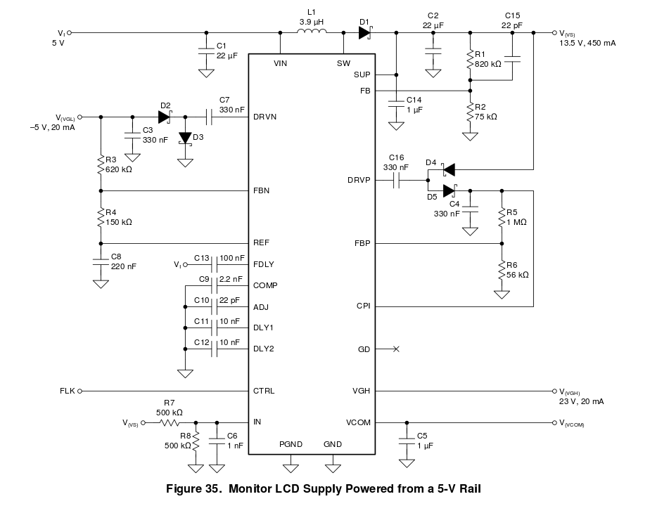

I use the above circuit. My problem when I fed 5V input, the outputs are good but they fall very quickly to 5V. I don't know what to do?
Thank you
    I see from another post that you are having the same difficulties with the TPS65100.
    What is the exact measurement setup for your tests? Are you using the EVM's (TPS65100, TPS65150) for your tests?
    What PCB development tool are you using? Can you share with me the files (schematic and layout) of your design?
