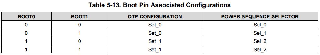

My customer is asking about POWER SEQUENCE SELECTOR. We can select three cases as Table 5-13 but I can't find the detailed explanation of Sel_0, Sel_1 and Sel_2. So can you let me know which document we should refer?

    For both TPS6590376 and TPS6590377, BOOT0 selects between 1.35V and 1.5V for SMPS3 output (DDR supply).
    BOOT1 selects whether RESET_OUT toggles low or not during the warm reset sequence.

    Thank you for your comment, but I can't understand the meaning of Sel_0/1/2. I think we can choose three sequence by BOOT0 and BOOT1 setting. I'd like to know the three sequence pattern.

    I think that table is not entirely accurate. There should be Sel_0 through Sel_3 - each of those 4 cases can have a different sequence.
    In TPS6590376 and TPS6590377, you can think of it implemented like this:
    Sel_0 = RESET_OUT remains high during warm reset.
    Sel_1 = RESET_OUT toggles low and high during warm reset.
    Sel_2 = Sel_0
    Sel_3 = Sel_1
    Sel_2 and Sel_3 are the same as Sel_0 and Sel_1, which means BOOT0 has no effect on the sequence selection. So BOOT1 effectively selects between the two sequences where RESET_OUT behavior is different during warm reset.
    If you look at figures 12 and 13 in the user's guide from my previous post, you'll see a diagram with the different sequences based on the BOOT1 pin.
