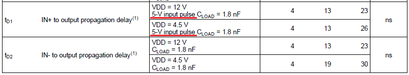

Hi Team,
I would like to ask two questions about switching characteristics of UCC27517A.
1)
The condition of "5-V input pulse" is described at tD1 only.
Is there any reason there isn't the same description at tD2?
I believe it is abbreviation but would like to confirm just in case.
2)
It seems the value of propagation delay is specified under "5-V input pulse" condition.
If my customer uses 3.3-V input pulse, how much does it affect the specification?

  • Yaita,
    For the 1st question, the test condition would be the same for the IN+ and the IN- input pins. Both have the same comparator input, with the In- pin having an inverting path to the driver.
    For the question 2. The UCC27517A is a fixed threshold input configuration. Propagation delay is defined as the time from crossing the input threshold (2.2V high, 1.2V low) to the time the output rises (of falls) 10%. The peak amplitude of the input signal does not change the time measurement, since it is a fixed threshold.
