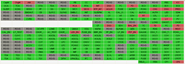

    This is a screenshot of the bits after the failure (scan enabled):
    If I reach the end of the of the 6 Hours cycle, if failed the first few days with "QEN" not set until I realized I have to press the "Gauge_EN" button after around 5 hours to manually enable the Gauge. I actually thought the automated cycle is doing this for me.

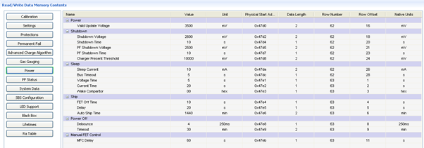

    close to the end of the discharge cycle but with the battery voltage still at approximately 6.5V, the bqStudio lost communication with the bq40z60Eval board. the discharging thresholds was st to 6000mV, CUV = 2500mV, CUVC = 2400mV, Shutdown Voltage 2600mV, PF Shutdown Voltage 2500mV. All protection features were disabled. I cannot see a reason why the device would turn itself off before reaching the 6000mV termination voltage setting of the learning cycle. I could discharge the battery to 5900mV when I recorded the battery characteristics to determine the chemistry ID.

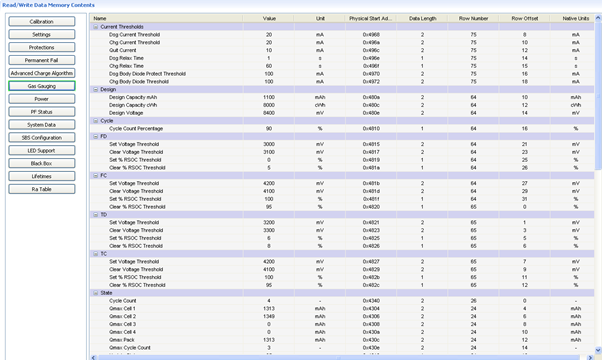

    Here are my current register settings:

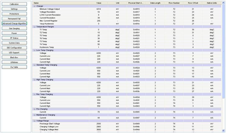

    I changed in Advanced Charge Algorithm -> Termination Config -> Charge Term Taper Current from 60mA to 50mA.

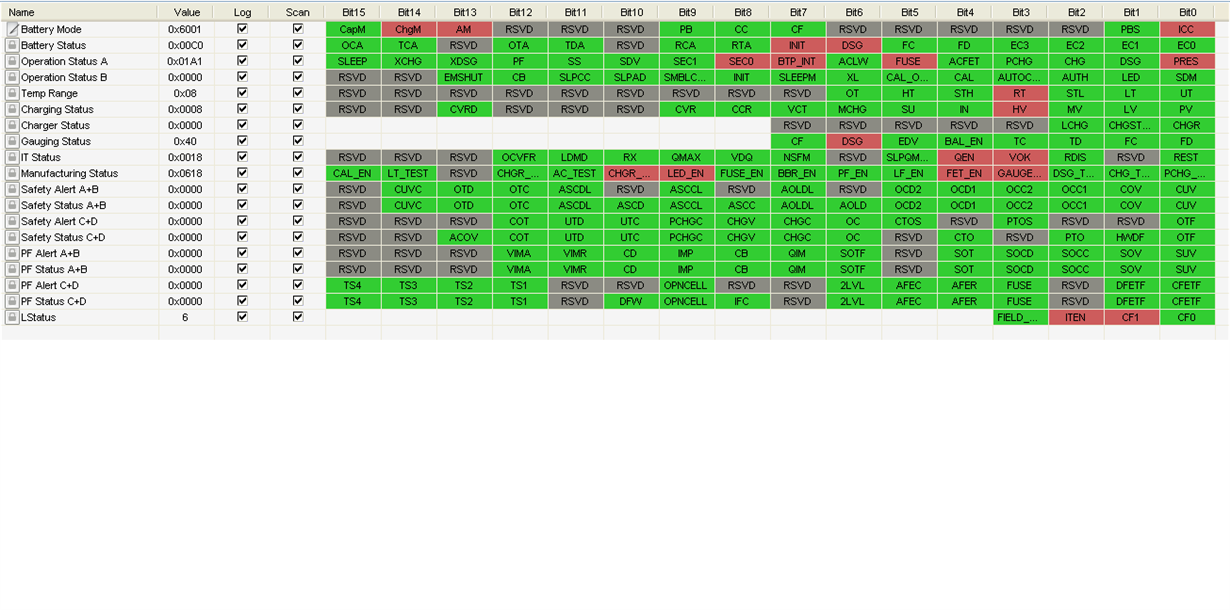

    Here is how it looks like:
    Thanks again and please have also a look at my previous posts. Perhaps you can see what is going on.

    In the last post, one cell was most likely damaged as it charged over 4.3V and triggered the 2nd-level protection which set the Fuse pin high.
    The same cell was also discharged below the set minimum cell voltage, even the stack voltage was within specs,  which caused the bq40z60 to turn off and communication with bqStudio got lost.
