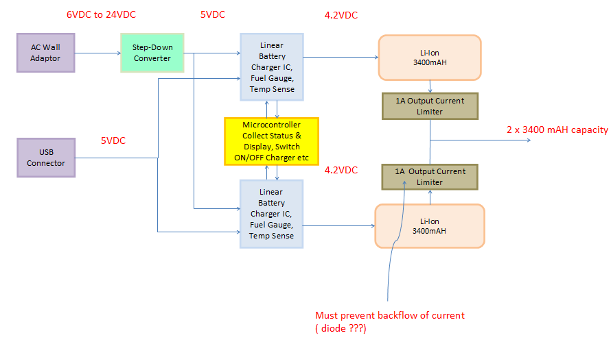

For our project, we decided the below requirements:
Battery Type: Lithium Ion
Battery Dimensions: 18650  (18mm Diameter, 65mm Length)
Topology - Parallel (1s2p, 1s3p or higher)
Requirements
- Since both Li-Ion batteries are connected parallel, both battery should be able to charge evenly, and use batteries evenly.
- Protection circuit for Short, Overcurrent, Overvoltage, Overtemperature etc.
  If one battery damaged, no change to circuit, remaining batteries operate as usual.
- Should allow charge state to be measured accurately.
- Maximize the number of cycles. Accurately charge to required max voltage.
Details
- 4.2V Max Output for Charger.
- Allows either USB or DC voltage input to charge. (suggest switch mode ??)
- Allows charging while operating.
- Pre-charge, CC, CV, Terminate. Charge evenly all batteries at 1C or less at same time.
- Battery Gauging
  - Should account for load/no load, temperature variation.
    (TI has 'Impedance Track' feature & Voltage Profile Database)
For  bq40z50-R1 fuel gauge, it is supports up to four series cells.
We also looking at the BQ27500-v130....
Can it be used to monitor the battery system as proposed?
But we plan to charge the battery in parallel as mentioned above.
Is there any suitable battery charger or fuel gauge that fulfill the requirements?
Please refer attachment:

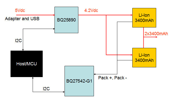

  • Hi Fernando,
    From your explanation, i assume the configuration of my battery system should be as below?
    Please advice...
    So, BQ25890 will charge these 2 Li-Ion simultaneously as mentioned right?
    As you mentioned for cell balancing, does it mean both Li-Ion battery level will be the same after being used for some time?
    So, BQ27542-G1 only track either one of the Li-Ion battery fuel gauge only?
    Thk,
    Br,
    Wang
  • Hello Wang,
    The block diagram seems correct. The 890 will charge both cells in parallel at the same time, then they will balance themselves. The bq27542-G1 will monitor both cells in a 1S2P configuration, remember that a 1S2P is still considered as one cell, so the gauge will monitor the voltage of the two cells in parallel and the current flowing through both cells.

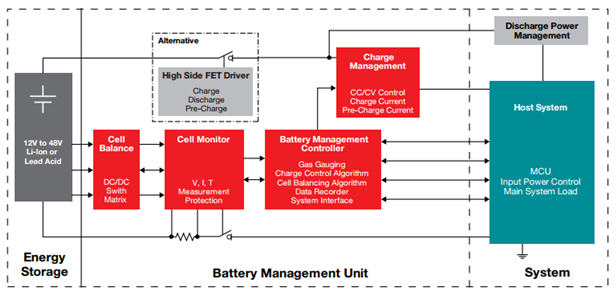

  • Hello Wang,
    The minimum number of cells in series the bq78350 can handle is 3s; the application we have been discussing is 1s, I don't think the bq78350 will work for this application.
  • Hi Fernando,
    We revise the requirement to 4s in parallel.
    Please refer below revise diagram...
    In this case, we choose bq76920 fuel gauge because it can support from 3S to 5S cell and integrated with cell balancing FETs.
    The TI also suggest that we use bq78350 as the gas gauge and battery management controller.
    Currently we are thinking whether or not we can skip the bq78350 and direct interface the bq76920 with the host (MCU) through I2C.
    This is because bq78350 interface with SMBus and it is just a companion to bq769x0 series for SMBus host interface and LED purpose.
    Please advice.
    Br,
    Wang
