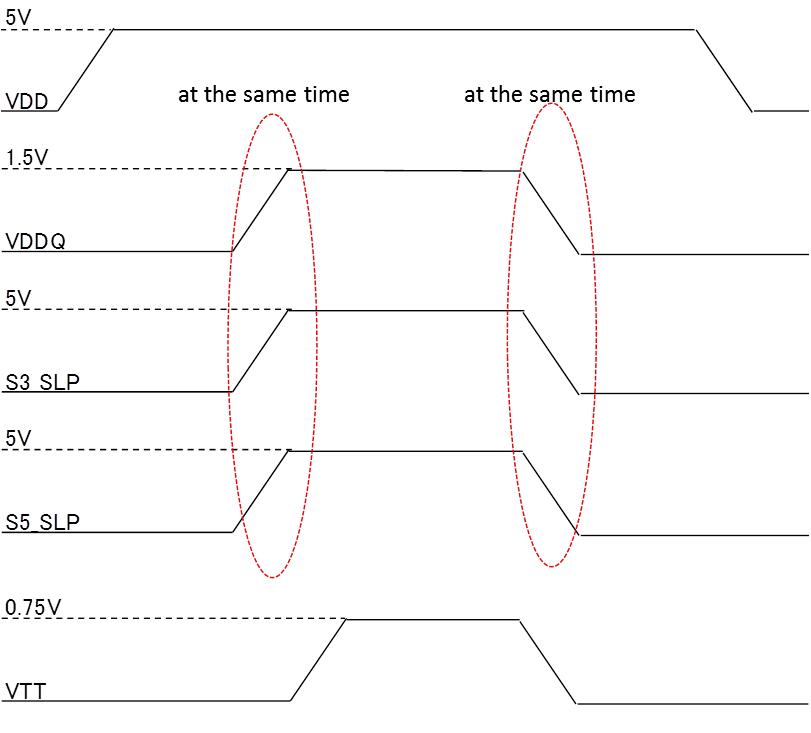

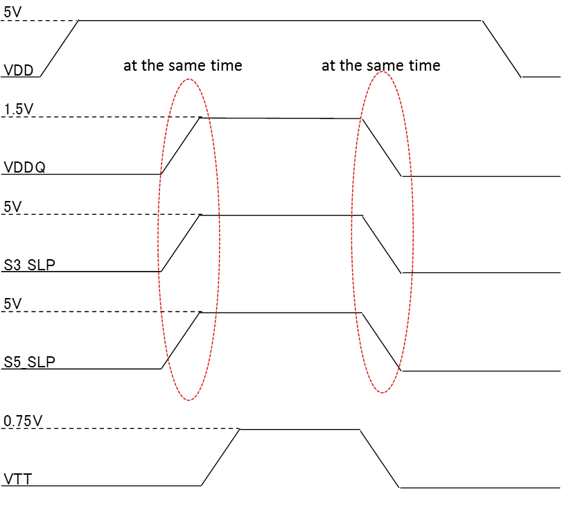

Hello Team,
I'd like to ask you about the sequence for TPS51200/6.
Can TPS51200/6 control the output of VTT if S3/S5 pin is high or low at the same time that VDDQ is supplied?
