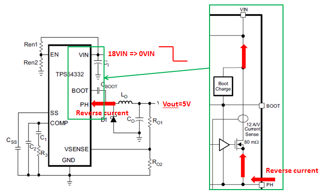

Our customer would like to use TPS54332 at the following conditions.
If the input voltage falls(18VIN =>0VIN), the output voltage becomes higher than the input voltage (VIN < VOUT).
Then, does the reverse current flow from the output side through the input side?
I guess that if the internal high side MOSFET have the body diode, the reverse current does flow.
Is my understanding correct?
[Conditions]
Vin=18V
Vout=5V
Iout=3A(max)
