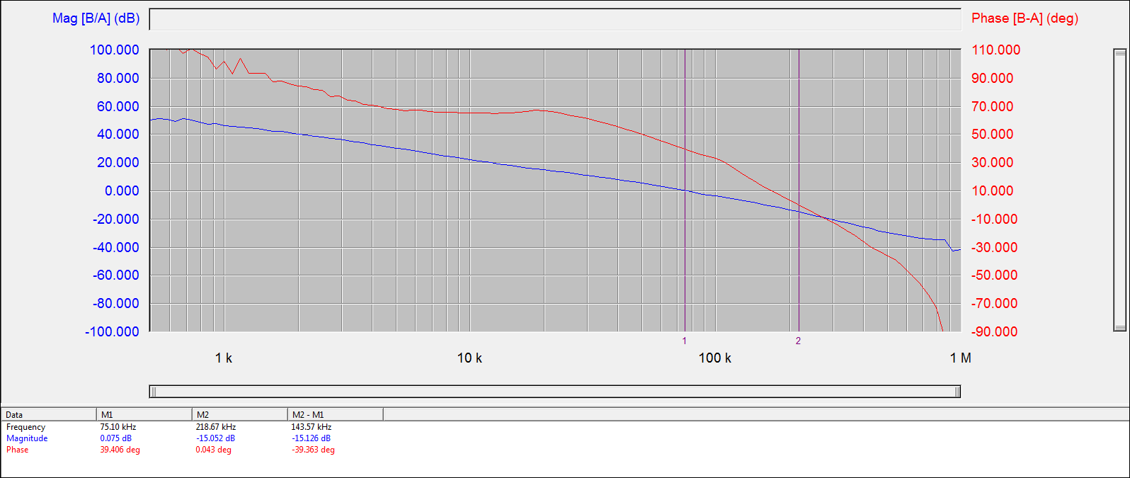

Hi all,
We are in need of crossover frequency chart of TPS65266-EVM.
Please provide for us.
Thanks and regards,
Nagai
Nagai,
test status, Vin 5V, full loading
buck1: crossover frequency 59.5 degree
buck2: crossover frequency 75 degree
buck3: crossover frequency 61 degree
Jason Wang

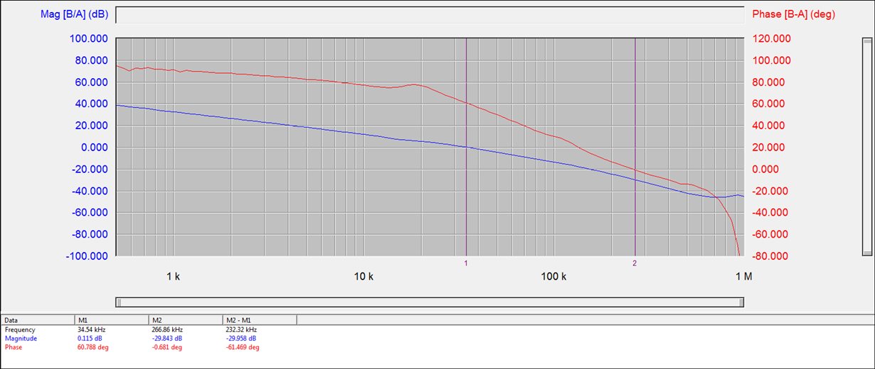

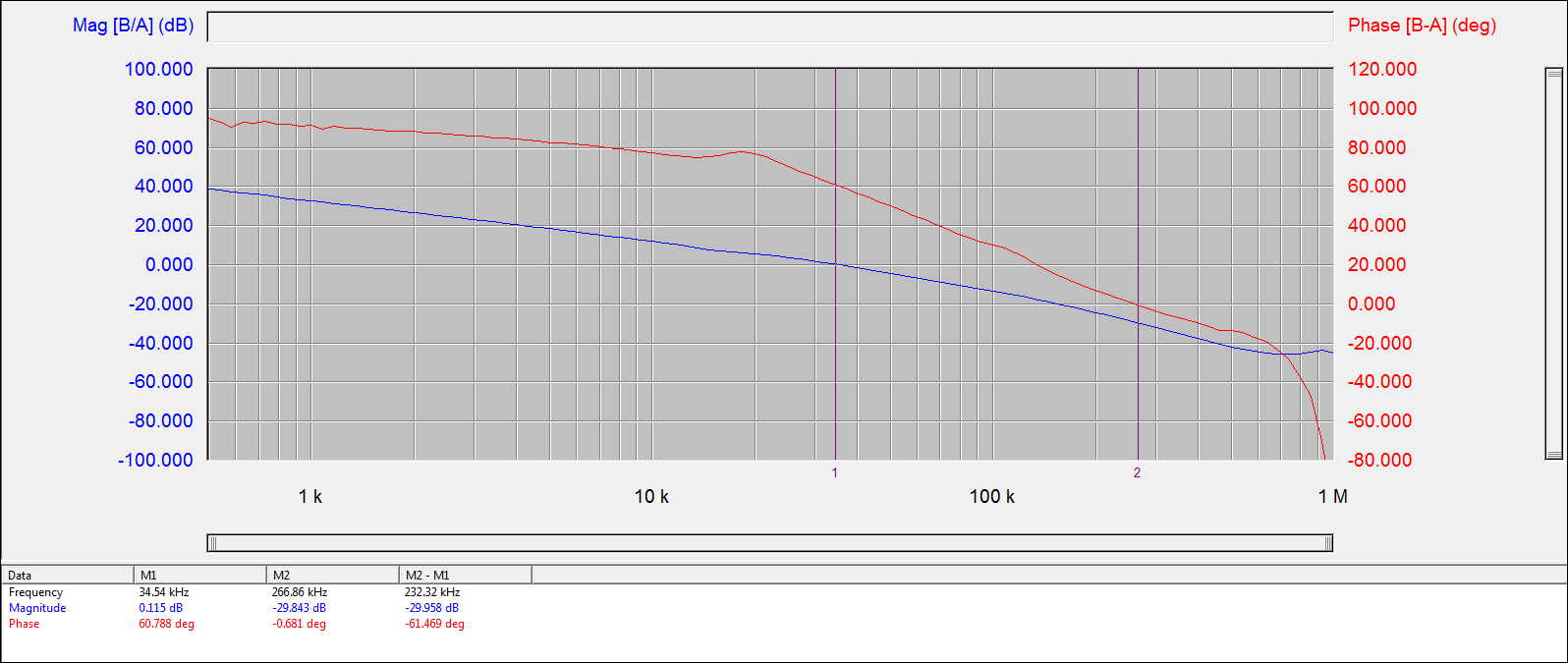

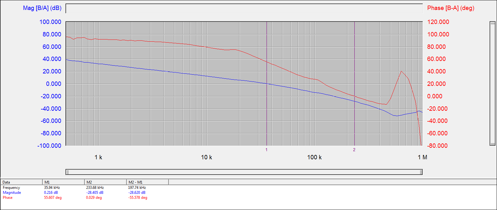

Nagal,
yes, the result is under FSW 1MHZ from our offcial EVM board.
Jason Wang
Hello Jason,
Thank you for your cooperation.
By the way, I have a question.
In previous post, crossover-frequencies were follows:
Did you change the conditions?
Nagai
Nagai,
The changings are based on EVM schematic.
http://www.ti.com/lit/ug/slvuad7a/slvuad7a.pdf
buck1:
C6 change to 3.3nF, R3 change to 6.6Kohm
buck2:
C16 change to 4.7nF, R10 change to 11Kohm
buck3:
C20 change to 4.7nF, R15 change to 11Kohm
Jason
