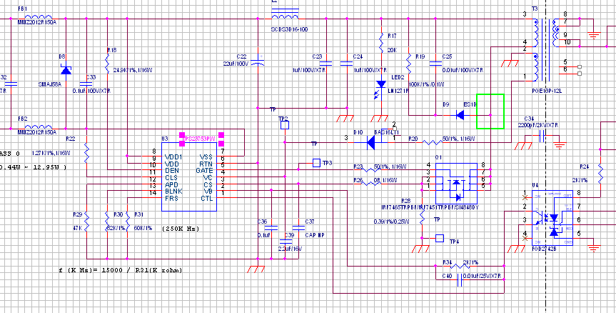

  • hello,are you solve the problem? I met the same problem,
    48V input, first test TP2 is 7.34V(see datasheet Vc power need 9V),TP3 is 0.11V,but not output 12V.I change R20 (50E) to (33E),  test TP2 is 0.037V,TP3 is 0V,why, the IC burn out? i changed R20 to 50E,but TP2 alway  0.037V,TP3 0V. 12V always not output.
  • I cannot find any issue with your schematic but it is hard to read (a PDF would be better). If your feedback loop isn't working properly (or running open loop), you can exceed the rating of the Vc pin and damage the GATE driver output. Check GATE-RTN resistance with a meter.
    Check that your PCB match's a correct schematic. For problems of this sort, it is best to test the dc/dc converter first by applying a current limited low dc voltage between VDD/VDD1 and RTN (bypass the PD controller). Slowly ramp up the voltage above 9V and check circuit points with a scope to verify switching. Using this method can allow you to find the problem prior to blowing up the IC.
  • hi,Eric
    my  schematic is pdf file ,2133.SCHEMATIC1 _ PAGE1 PoE & DC & I.pdf
    I had change new U3,while input 48V,test TP2 is 7.36V,tp3 is 0.11V ,transformer T3 touch hot. restart again,test TP2 0.037V, U3's Vc(TP2) to earth 10E,same schematic and param,the U3(TPS23753PW) is so easy damage,or it  is so easy protect status. depressed....
  • TPS23753 is a very mature, reliable product. The problem is most likely a simple layout or BOM mistake. I will review your attached schematic more closely tomorrow to see if anything obvious shows up.
  • Try to add more bulk capacitance on the Vc pin (10-22uF) to help with start up. Also, what actual Q1 is installed? We have had some issues with certain FETs that are NOT logic level Vgs(th). Again, try to use a scope to debug your start up behavior and not a meter.
    "For problems of this sort, it is best to test the dc/dc converter first by applying a current limited low dc voltage between VDD/VDD1 and RTN (bypass the PD controller). Slowly ramp up the voltage above 9V and check circuit points with a scope to verify switching. Using this method can allow you to find the problem prior to blowing up the IC."
  • Hi,Eric,
       first thank you very much, I  had solved the program, the D5 diode is reverse, but i not understand no output 12V,that be able to damage the IC U3?
  • If the circuit runs open loop (since D5 was in backwards, the dc/dc will try to go to full duty cycle), the Vc supply will exceed the ratings of the IC and cause damage.
