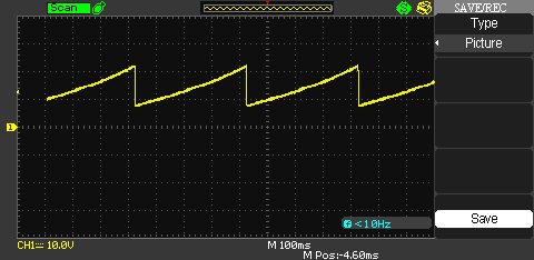

     I am  getting ramp waveform in the VDD  pin ,and there is no Pulse in DRV  pin .i have changed capacitor value (C6  ) and tested after that removed the capacitor (C6) and tested , still i am not getting any pulse in the DRV pin .

  • Hello Karsan,
    Bernard is on holiday. So I will look into this for you.  This looks like the device starting up into a fault.  I don't believe it has anything to do with the VDD capacitor.
    When the UCC28700 is powered up it will give three sample pulses to the gate drive to figure what the output voltage is. If there are any faults the device will shutoff off and discharge the VDD capacitor to VDD turn off.  The trickle charge resistor will recharge the capacitor to Vdd turn on and initiate sampling again.  If there are no faults present gate drive switching will continue.
    The faults for this device are over current, over voltage, input under voltage and over temperature.
    If you reevaluate the VDD waveform with the gate drive, and the auxiliary winding voltage, you should be able to see which fault is being triggered.
    Mike
    We are giving Input voltage upto 230 V. VDD pin generating Ramp waveform only. If we increase the voltage the ramp waveform charging time only reduced. we are not getting pulses in gate DRV pin it's always zero. There is no voltages on auxiliary winding, VS and CS pin.
