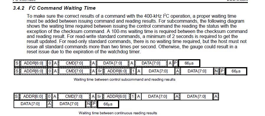

  • Writing subcommands are a little different from the standard commands.
    You need to write to the control register, then issue the command, then read from the control register and address as shown in the snippet below from the TRM:
    if 66us time doesn't work, increase the value to 100us, Try different timing until you get something that works all the time.

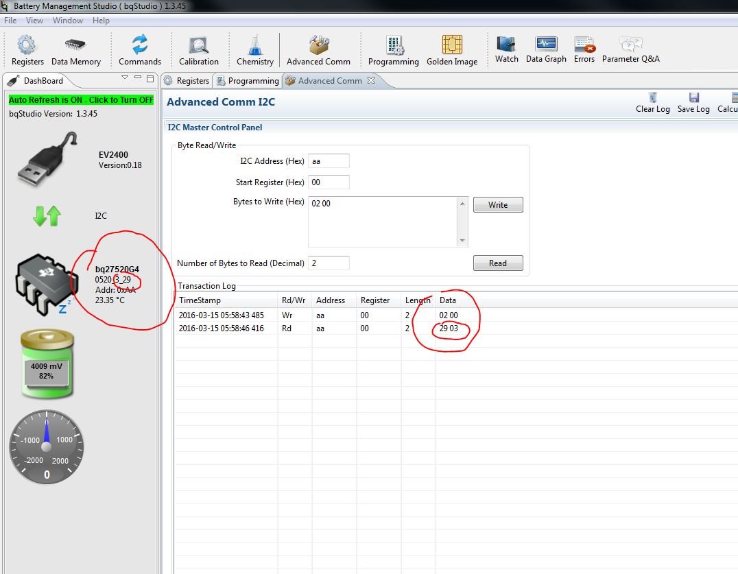

    Using the gui, i was able to read the firmware version which is 329
